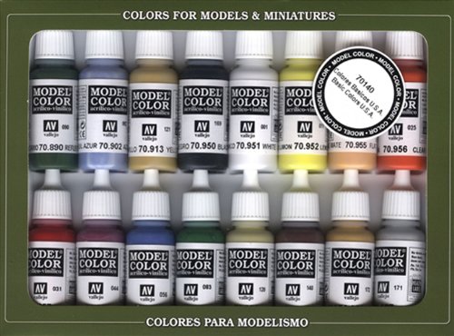

uh, not sure.. I'd have to look. I used the paints for lead/pweter 1.5" figurines. I'll snap a pic of the kit I got off amazon.

Tester model paint works well. Matt (flat) white and fire engine red look decent . Use acetone not paint thinner. Do a thin coat, let dry. Then a heavier coat, let dry. Don’t spent too much time worrying about being in the lines. A rag with acetone will wipe off the paint not in the engraving. I’ve done this for a few rifles. Looks good and seems to last.
This is the paint I got/used:
https://www.amazon.ca/gp/product/B009162PWU/ref=oh_aui_detailpage_o05_s00?ie=UTF8&psc=1
