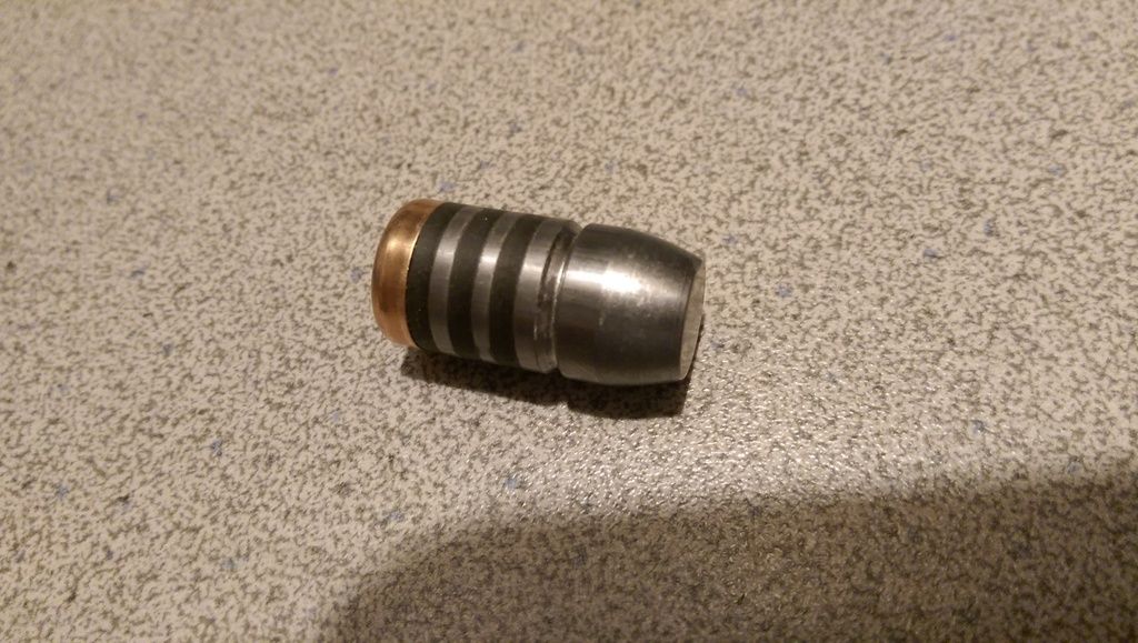

I cast some 500gr gas-checked FP's for my .500 Jeffery. I went to check for fit and the bullets were jamming in the lands. I had to mill .003" off the nose diameter. Looks like Blasers have virtually no freebore.
Nice, that's a beast! What sort of velocities are we talking?

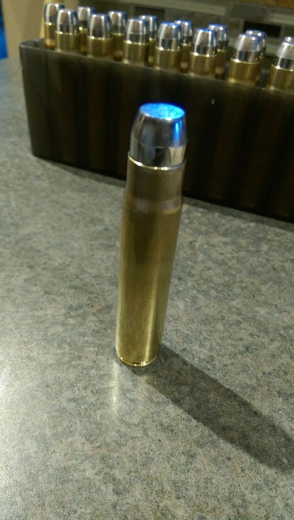

I decided my powder shelf was too full so I loaded some 470 Nitro Express.........that gets rid of powder containers in a hurry. 500gn Woodleigh with 110 gns of IMR 4831 behind it lit with a fed 215. Load 100 rds and get rid of the better part of 2 lbs of powder.
I also found 200 primed 357 Mag cases in a bucket and just happened to have a couple boxes of Horn 140gn XTPs. So between the 470 and 357, I was able to open up some room on my bullet shelf as well.
