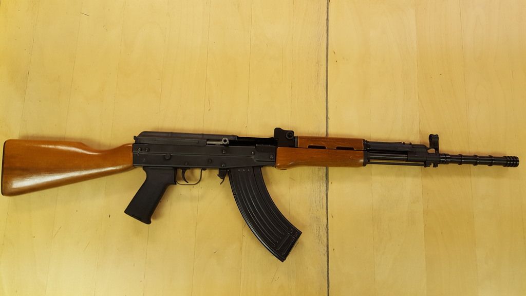

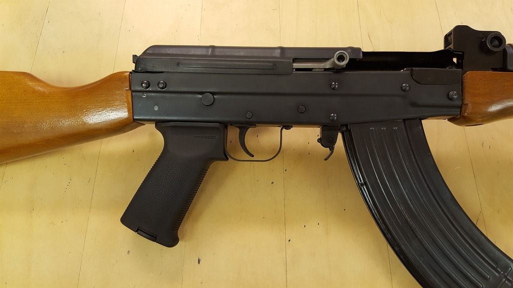

Magpul Moe AK grip on a type 81 anyone :)
I had to do a stupid amount of grinding to get it to fit around the grip pan (not fun).
The screw that comes with the Moe grip is the correct thread pitch and bolted right up, but you almost need three hands to get everything lined up.
Overall I think it looks pretty good, and for me it feels much better than the stock grip.

Take an overall pic of it for us!!!!
