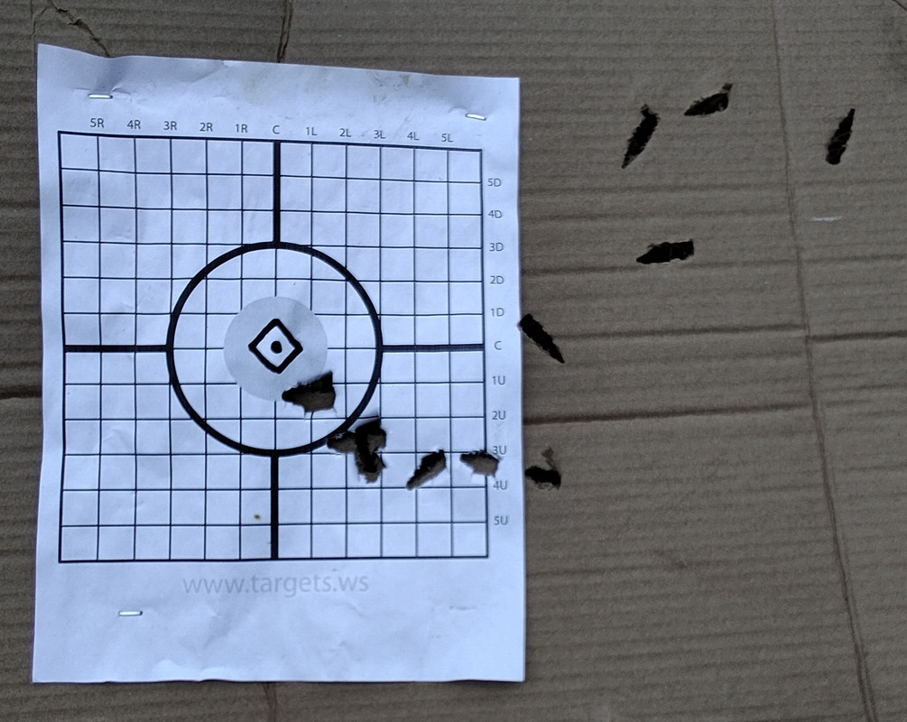

I'll spend some time with it tonight and do the suggestions.i should get a better rod. One that rotates with the rifling better. It groups not to bad. Still key holing. I did get a couple of round holes last time but mostly keyholes. $2 a hole:)
Don't see or feel a bulge. I broke the rod ordered a one piece with a bearing. Should be able to follow the rifling better. See if it stops following anywhere along the bore. I'll dig through the tackle boxes and get some lead ready. Tried some old full jacket 147gr that I had. That's the fmj top right. Worse than the jacketed soft points. Used some 150 and 180 not much difference. Ill see if I can find some of the ammo mentioned earlier in the thread. What are some flat base rounds that won't break the bank.

Are those groups at 100?
Kind of nuts how tight they are considering the sideways bullets
About 45 yards. Best I could do in our clearing. Haven't dialed in the scope yet. I can setup a hundred yard range but I have to put critters away. Wanted to get nice holes first

Update so far my friends. No break through. Shot some flat base 150gr Hornady whitetail. Flew wild got worse with each shot. Used six rounds. Got some brass incase I start reloading. First shot was a bit of a keyhole way off target. Remaining shots were full keyholes all over the place. No need to print off more targets. Got a new rod with a bearing. Put a flag on the end. Starts spinning right after the chamber pretty much to the muzzle. Still have to try the lead ball. Cleaned with sweets no signs of copper. Eye balling the bore looks good. Getting ready to buy a bore scope.
Ordered a bore scope. Not sure how to pour a chamber cast. Shot some 110gr federal today. Tumbling all over the place. I'm thinking I'll need to lap the bore. Thinking there are burs. I'll find out when I get the camera. In the meantime what's an easy way to remove any burs. Or what are the ways. Compound on the bullet and shoot the burs polish the bore?

Barrels fouled or worn out… something. Lapping will just wreck whatevers left. Do some reading on the marlin forums about micro grove rifling. Stop wasting money shooting jacketed bullets and don’t buy a Chinese borescope, pretty much any borescope will give you more questions and doubts than answers.
Go see a reloader you trust, clean the barrel properly and shoot some cast bullets. https://www.brownells.com/tools-cle...ers-cutters/cerrosafe~-chamber-casting-alloy/.
You probably could of paid a decent smith by now to figure it out
