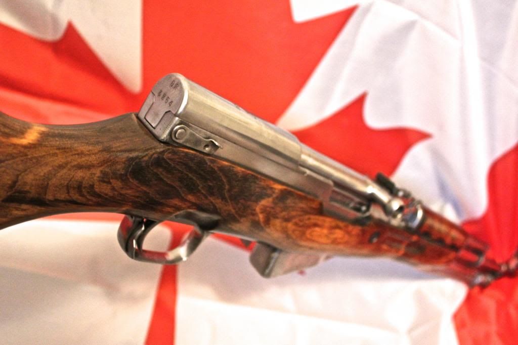

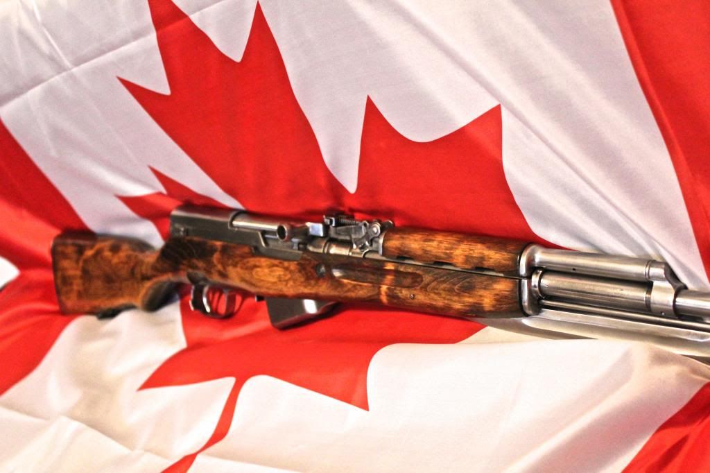

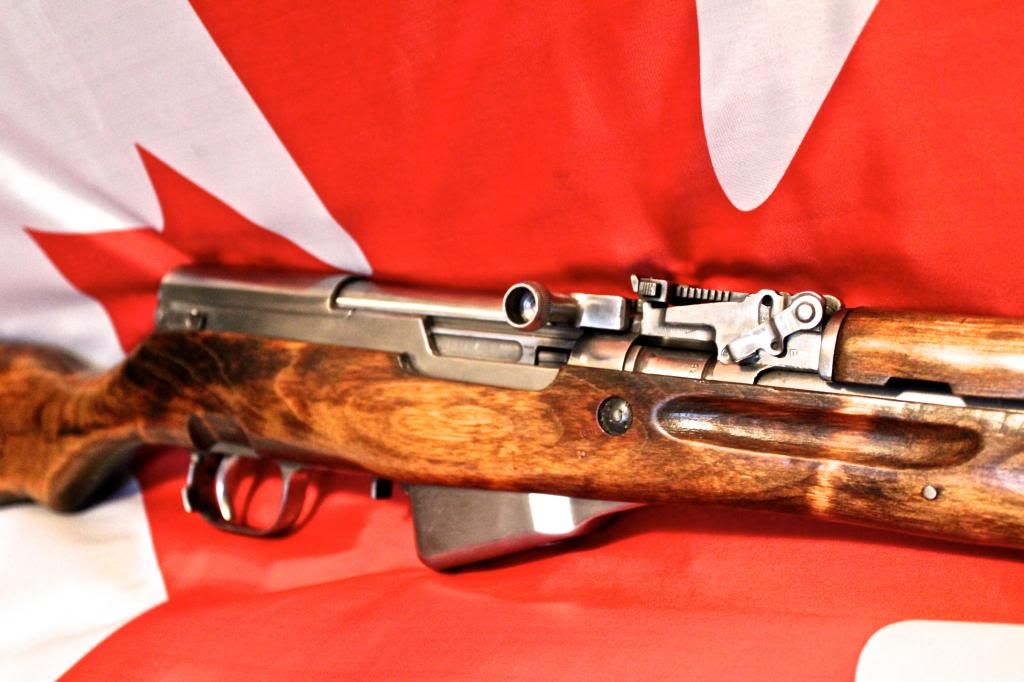

This is a Chinese military Type 56. The pistol grip has been moved forward to improve the rifle's balance
The trigger guard doubles as the magazine release

^^ For the stock i stripped it with a varnish stripper, then gave it a light sanding. Then i used a little bit of walnut gel stain, followed by about 10 coats of tung oil.
For the barrel, receiver etc- i stripped the blueing with white vinegar, 1500 grit wet sanded where i could, and dremel polished the hard to reach places, then hand polished with plain old automotive polish. Pretty easy to do, just a little time consuming
