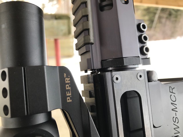

2) Even when torqued down tight, the handguard will slide forward when shooting, in as little as 10 rounds. I believe this is because the tab that locates the 3D printed spacer fits in the slot between the bolt tabs at the rear of the handguard and does not permit the handguard to be tightened enough. This should be able to be fixed by either removing the tab altogether or thinning it down. Not sure if the spacer will stay in place with the tab completely removed. Had they used a proper fitting handguard, I don't believe this would have been an issue.
I'll try it tomorrow with the spacer removed completely and see if the handguard stays in place.
What exactly is the purpose of that spacer?
The top rail is longer than the rest of the handguard and the spacer fills the gap. Here's a pic of it slid forward. You can see the spacer at the receiver end, below the pic rail.
Removing the spacer did allow the handguard to be tightened sufficiently to not slip. It just looks bad now. Though I'm not sure it's really any worse than the 3D-printed part.
What would happen if someone just machined that rail flush with the handguard?
Or what about machining a matching step onto the receiver rail?
That's probably what I'll end up doing. I'd drill the hole for the anti-rotation pin deeper before milling it off to avoid having to drill it without a guide after.
