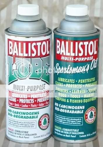

For several years now, I have been using Ballistol on my guns, and have been very pleased with its performance -
http://www.ballistol.ca/Ballistol/Pages/Ballistol_Products.htm
Apparently it was developed in 1904 as an all-purpose lubricant and protectant for guns and equipment for the Imperial German army - works well on metal, wood, leather, etc. ..... Here's a rather long and detailed page of information about it - http://www.ballistol.ca/Ballistol/Pages/Ballistol_Index01.htm
