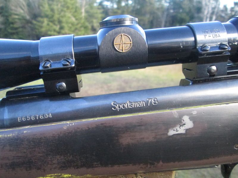

In the spirit of boasting one's new wares here on CGN, I submit this 35 Whelen "Rat Gun" (ala Rat Rod). I think it runs a bit counter to all the pretty guns one sees on the interweb these days. :cool:
Built on a Remington Sportsman 78 ADL action (1980s M700 pre-SPS cheapo offering) with a new 23" Lilja 1:12" SS bbl in an old Brown Precision stock. This is the fourth rifle I've had that stock on starting with a used 7Mag that was re-tubed to 358NM by Bevan King. That 358 was sold to a friend who decided a McMillan was in order so the stock was sold back and was put on an 30/06 only to finally become this current 35 Whelen. (This has become my all time favourite stock over all others that I have owned. I wish I had a bunch more of them.) The butt was extended 1/2" to bring it up to 13.5" and given the BDL treatment. I started to refinish the stock at one point and found some yellow under and couple layers of brown and black paint. Kinda ugly, so I left it as-is. Scope is an old Vari-X III 2.5-8 complete with gloss finish, ring marks and friction adjustments < gasp :eek: >. Paid a mere $150US for the scope, so it's cheap enough be a a part of this project. The Weaver R&B are uber FUDD and were a no brainer. I just hope I can get all this antiquated optics gear to work enough to place a bullet even remotely near a target. :)
Weighs 7.5lbs as shown and handles quite nicely.
Go ahead, tell me it's ugly and make my day. I like it! :dancingbanana:

I like it Paul.....I have several of those Brown stocks and they are one of the best in my opinion. That yellow primer would indicate that it is an old Kevlar one which is a truly outstanding stock. I like the ergonomics of those stocks better than any other synthetic stocks. If you wished to de-rat it a bit, I have had great results with "crinkle" paint. Gives a nice appearance and texture and is quite tough. My 300 Wby 700 Rem is in one of those stocks designed for the Sako of old and the crinkle finish lasted many hundreds of thousands of miles and 10 or so years before I redid it.
Good to know that the yellow paint = kevlar. Thanks for that info.
I don't think I will be doing any de-rat refinishing to this one. Going to leave it as is, but I may install a FXII 4x fixed once I have some loads worked out.

I love it...... but I love it because it's ugly.......... hate those rings though..... :)
Lots of folks hate those weaver R&B but it's the most copied system out there, totally dependable, QD, cheap, rugged and flexible in application. Those are the four screw rings with screws on both sides. Big improvement over the older style for ease in mounting.
Ahhh...... I thought they were the super fuddly two screw ones...... carry on...... lol.....
