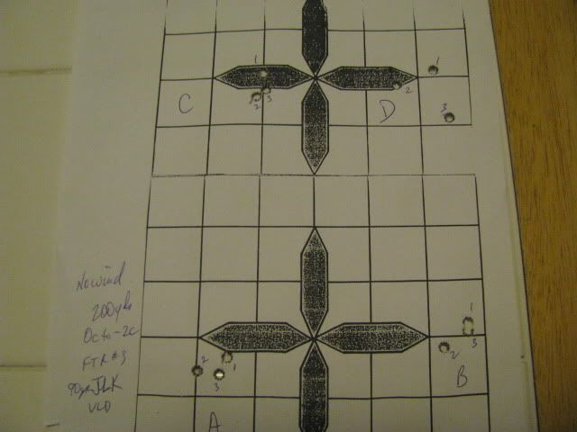

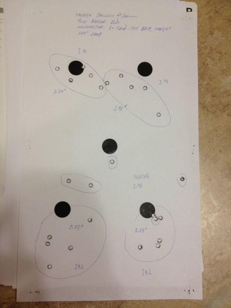

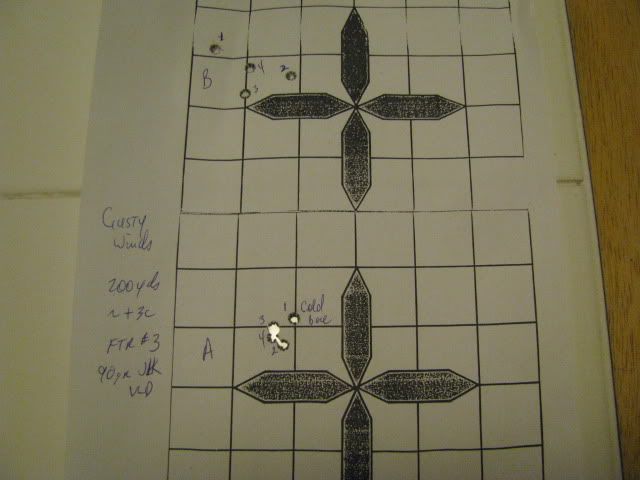

A bit chilly this morning but the winds finally slowed down to a gentle breeze.
200yds groups with 2 Shilen Savage FTR's. 1 barrel with 1500rds. 2nd brand new. Different seating depths (just how the 2 seaters were set up). Both showed a load that was 1/2" or better so that is very promising.
Hopefully, the weather will hold for more groups to confirm, at least at 200yds, the accuracy potential.
