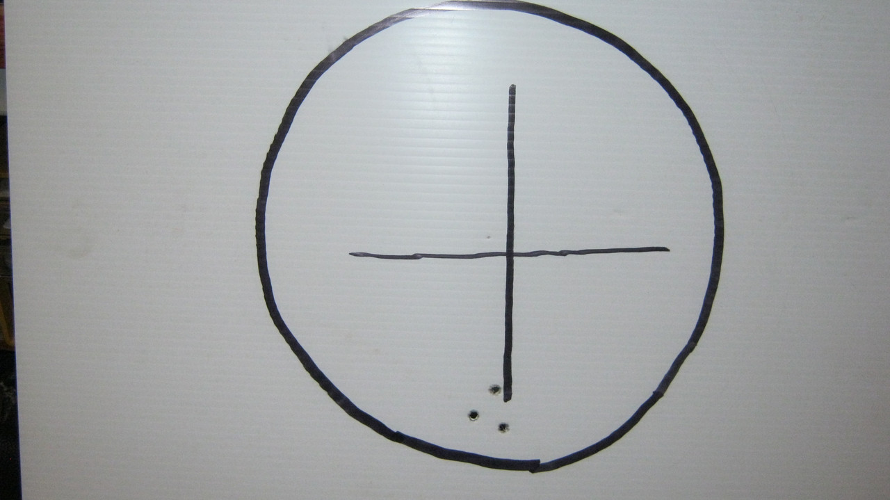

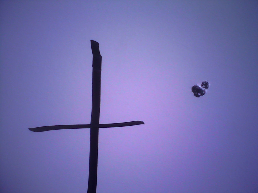

A couple of target results using Lapua 285gr reloads:
First result CZ 550 FS 5 rounds 100yds
CZ550 FS 200yds. 3 shot 1" group
ZG47 and BRNO 600 were almost identical results, under 0.50" at 100yds
