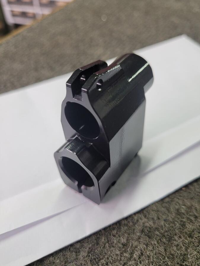

16mm gas block (18mm are here as well), we trimmed down the profile but left the front tab that holds in the gas regulator beefy so these boys are solid -

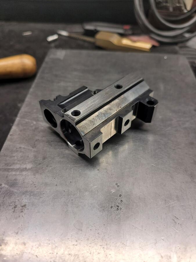

Trunnions are back from heat treat and will go for Nitride this afternoon -
Good update ?
