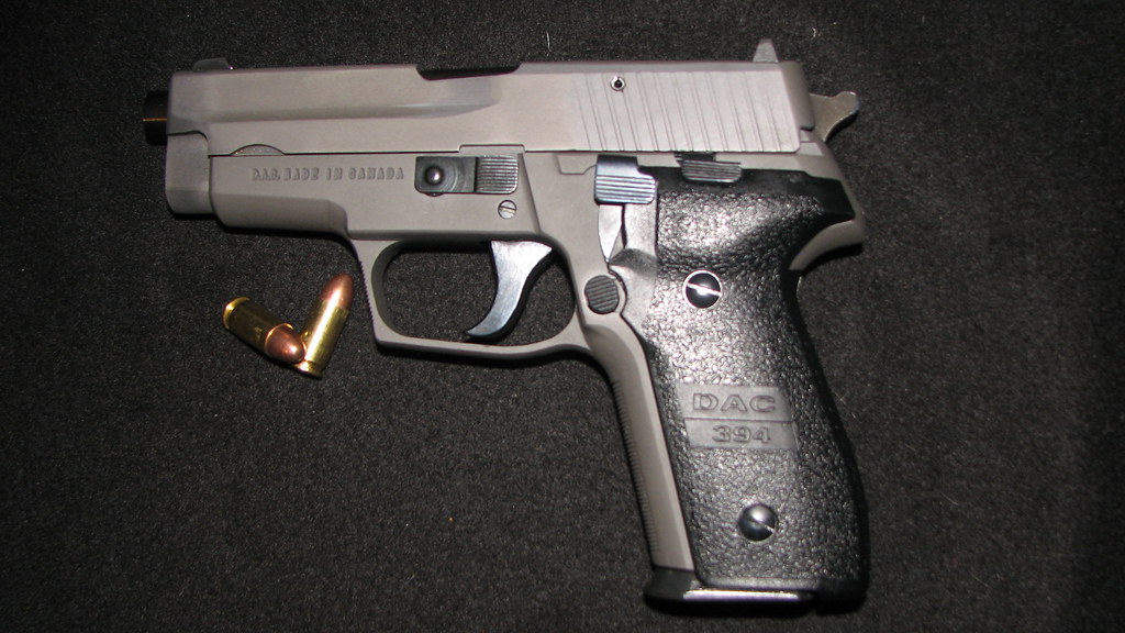

Well it will be back to DAC 394 gunsmithing 101 again tomorrow. Just got back from the range for the second time today. Could I leave well enough alone? Could I just plug my eyes and not read about DA. Oh No! Not this guy. I had to try and make it better. Well I believe that the trigger bar is now set so deep that I am getting multiple (more often than not) failure to strike failures. I think that when the hammer comes forward it gets caught by the DA hammer slot or it is rubbing on the hammer and not allowing it to move forward fast enough. The de-cocking is now not functioning either. I will have to get in there tomorrow and have a post mortem. On a side note, the guys at the range this morning were pretty friggin' cruel. Not one comment about "how it would be cool to build a kit." I got a fair bit of "I'm surprised Dlask would sell something like that". "Don't tell Joesef that you brought it here." We had discussed the kit and the price and as I was coping with clearing jams and failure to fire and such, I actually had guys behind me "bidding" on my pistol. "Oh! looks like the bid is now down to $99." as I had another failure to eject. Good fun ribbing is fair game but these guys with their uber expensive Swiss and German engineered, metal finished by three guys in a secret room in France, and hand oiled with oil from the the oil gland at the base of a unicorn's horn, target pistols, really were rather heartless.

Your de-cocker lever is quite a bit higher then mine....mine sits just below parallel with the slide where as yours seems to be a bit above parallel.

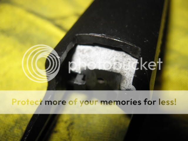

Breechblock split in half from slide roll pin failure. Looks like roll pins broke, allowing the breechblock to move backwards and the top snapped off.
This just confirms what others have said about the weak pins.
Anyone replaced their roll pins yet? where did you get them from?

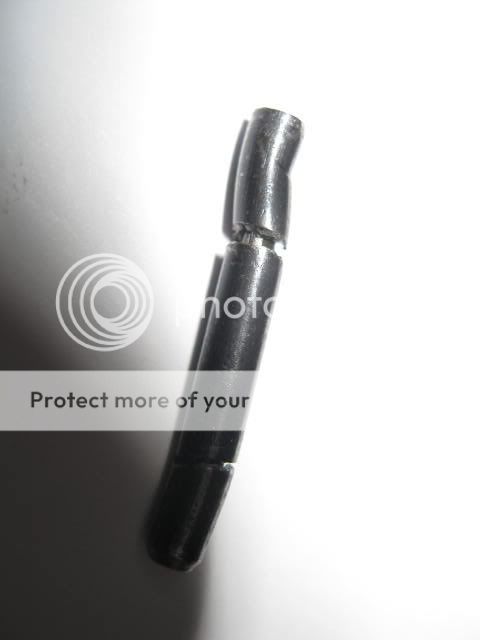

Yeah, I was running both pins....openings 180 deg apart. Here's a pic of mineDude, that sucks !you said "roll pins broke" ..... did you put the inner pin in and they still broke ?
I haven't replaced my pins yet, I've only fired 100 rounds .... and I did it with only the one pinyeah I knew better, but I was in a hurry to get it to the range.
I took my slide apart after I read your post, and my roll pin was bent. Here's a pic.
Yeah, I sent them an email explaining what happened and asking for prices on the parts, hopefully they have some. I also asked them if this is a known issue or is there something I can do to prevent this from happening in the future...hopefully they can help me out.Novega, have you contacted Dlask about a new breech block yet ?? I'm hoping they'll be able to help you out. If you need some roll pins, PM me or here's the link to the 3..5 mm pins from fastenal ..... like I said earlier, I'm going to try a 5/64" inner pin because I couldn't get 2mm pins without ordering a $hit load.
