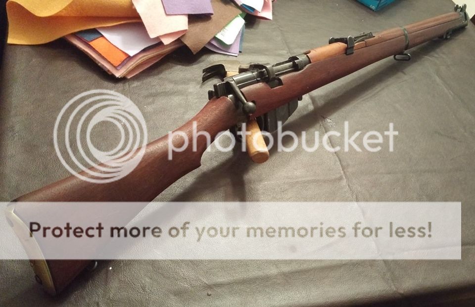

I'm looking to identify the markings on this Lee Enfield No.4 Mk1. Hopefully quickly as I have the oportunity to get it shortly if I want it.
Markings appear to be:
2B (or 2R but I think it's a faded B)
839
Markings on stock show:
72 7 (circled)
SWS
2088
I believe the rifle date was 1943, but I cannot confirm this unfortunately.
Does anyone know where this was created? Is it a legit Lee Enfield No4 Mk1 that was used in WWII? I'm thinking it has a lot of mixed parts from multiple rifles, but I can't figure out where they could be from. According to the store, there aren't any other markings on the receiver.
Any ideas on where it was build would be much appreciated. Trying to determine if I should get it for $695 or not. I'm looking for one used in WWII. Doesn't matter by who specifically. I just want to know where it was made.
Thanks for your help!

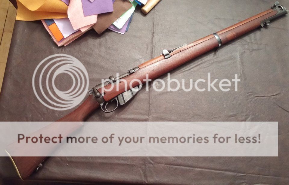

Looks a legit No4 Mk1...However, the first pic has a rifle with square cocking piece on the bolt and the second pic has the round button style cocking piece...Two different rifles..???
What makes you think its 1943 if there's no other markings to determine that..?
Markings I would like to see are on the left side of the butt wrist / receiver....These markings should determine manufacturer / date.
Markings on butt don't really tell me much...Issued to >>?? / rack numbers...
How's the bore / headspace check out..?
You need a bit more info on this rifle (s) to be sure you want to spend that kind of money...Unless its a Long Branch $695 would seem to be high....
Thank you for pointing that out... The store sent me 5 pics and it certainly does appear to be two different rifles... I'm not sure why they would have done this unless they got in a second in I went there last. Unfortunately I don't have pics of the other side at the moment because they weren't sent to me. However, via email the store said the other side has no markings.
I believe it said 1943 because of a conversation I had when I was in the store last. Unfortunately when I was there, I had little time and didn't pay much attention to the markings (I didn't know what any meant at the time, but have since researched them). Which bolt is the LB version (if either)?
Everything looks to be in great shape from what I saw when I was there though, which is why I figured the price was higher. I haven't seen any other No4 Mk1 in Southern Ontario within a 2 hour drive yet, so I have little reference at this time price wise. The store isn't exactly close, but I may be going there tomorrow to check it out. If it's a Long Branch then I'd snap it up, but otherwise it may have been someone's project and I'm less enthused about that (although it still looks great).
