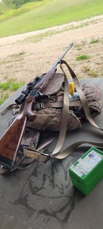

I restored one almost identical, and shoots almost the same. 9.3 for whatever reason is such a wicked shooter... Ive owned 4 and have yet to find one that cant shoot, Its IMO just inherently accurate. great shooting!I get them shooting as good as possible, no real downside to having accuracy.
Most run of the mill hunting rifles will shoot sub moa with a decent load.
This Bubba HVA 98 in 9.3x62 was pretty easy to get shooting tight, 70 years old or so, $400 rifle.

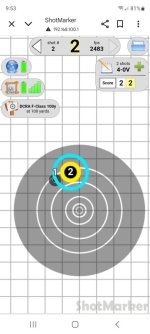

note for OP, that's a pretty good 12-13" group considering the variables, and good shooting, should take down any animal with proper bullet.
However will say I base my calculator factors at 8-10" kill zones. 12-16/ hell even 20" im sure are fine on moose and elk, I just error on the side of the caution.
