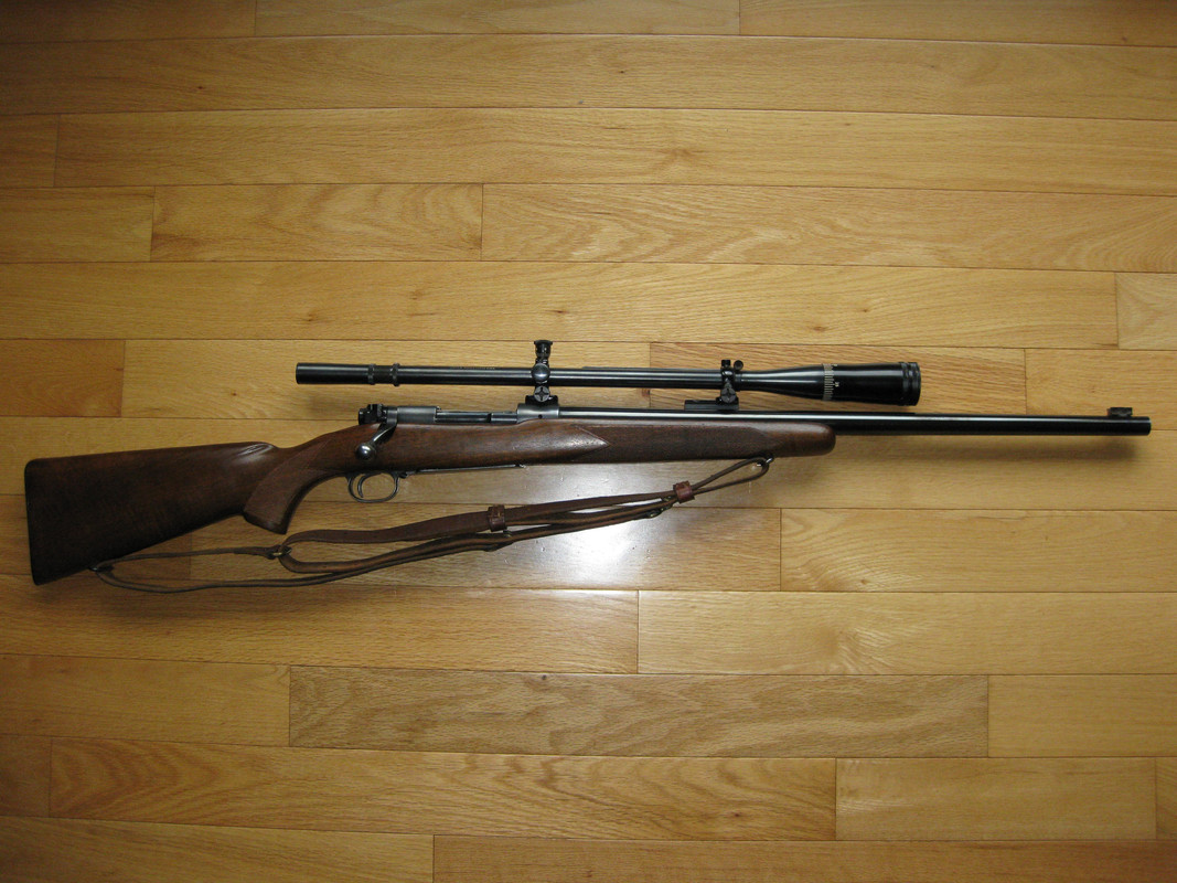

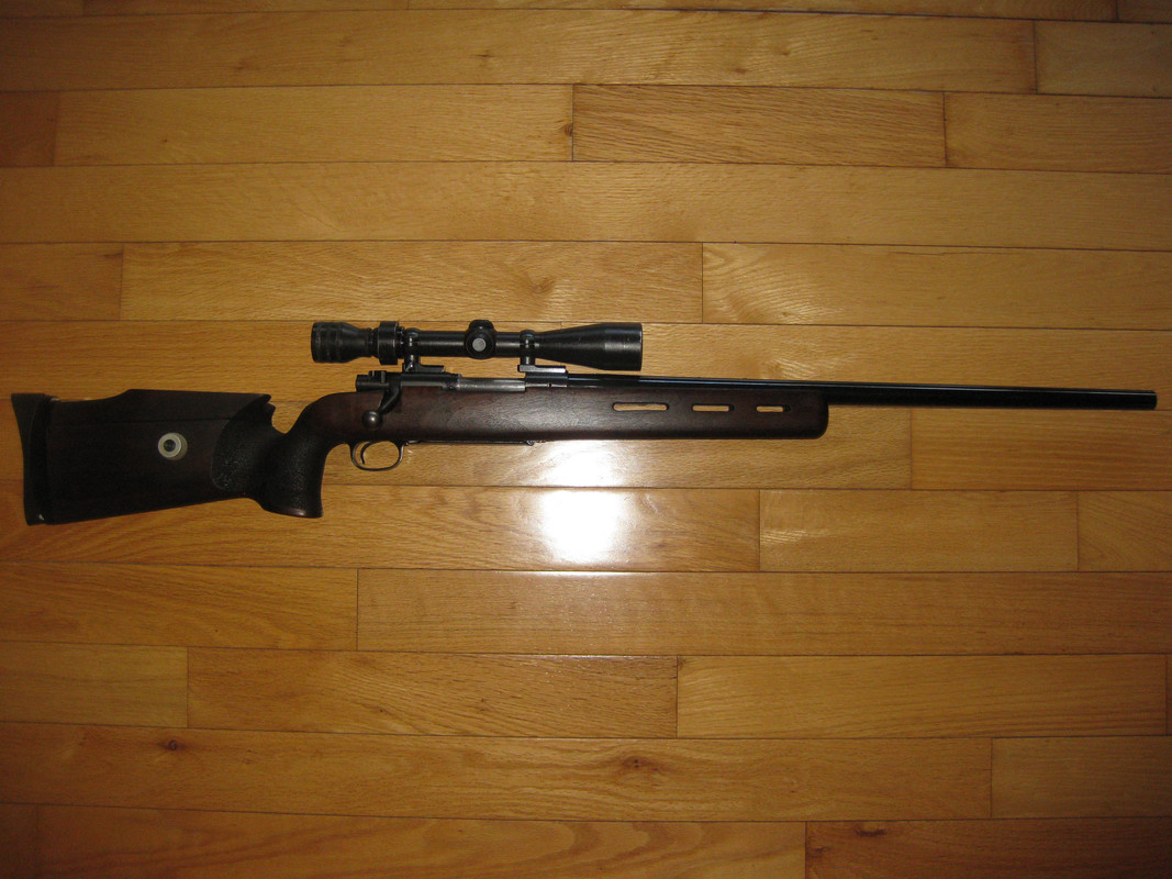

here are a couple of old school Winchesters, kind of related to the M40's in some ways
1951 30-06 with 12X Lyman and a 1969 .308 in IDF sniper stock complete with original ART 1 scope
