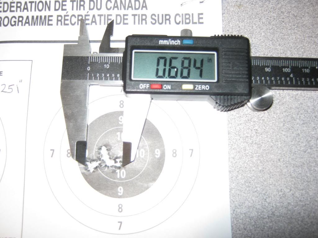

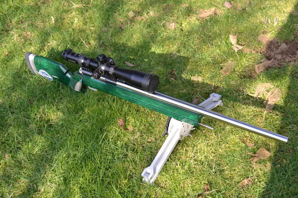

First time out to try this challenge. I must say that I had some grave doubts - I knew I had at least two - possibly three - rifles that could, in the hands of an expert shooter, do the job but I wasn't too sure I had the requisite level of expertise to pull off the job. Anyway, I decided to give myself the best chance possible and so I eschewed my F/TR in .308 and PGW Coyote in same calibre and chose, instead, to use my F/Open rifle: my Barnard in 6mmBR.
I had some thiry-odd rounds made up using the Berger 105VLD's (over 30.2 Varget) which is a bullet I've decided ins't so consistent for me as the Berger 108 BT's at longer range so I decided to burn them off in this short-range challenge. I shot from the prone as I always do and the rifle rested on a Henry Rempel bipod and I used a Protektor rear bunny-eared bag.
The range was Mission Rod and Gun, weather was sunny and about 7deg C

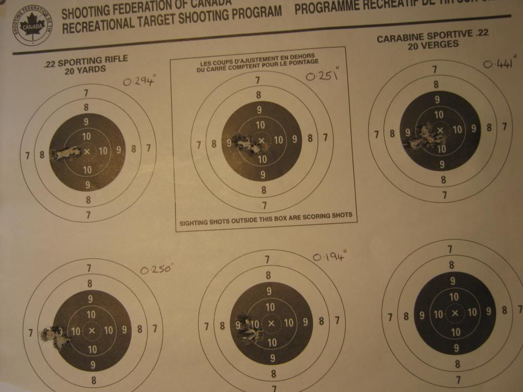

I never shoot at 100m so I fired 3 rounds at an adjacent target to confirm zero and then fired all 25 in an unbroken string at the target pictured below.
This is a picture of the biggest group - shot 3rd of the five shot. Thought I had screwed up but made it after all !
Rifle was Barnard with Kreiger 1:8. Robertson GBR stock. S+B 12-50 with 1/8th MOA clicks and P4 Fine reticle
Target 1 = 0.294"
Target 2 = 0.251"
Target 3 = 0.441" = largest
Target 4 = 0.250"
Target 5 = 0.194" = smallest
Mean Average = 0.286"

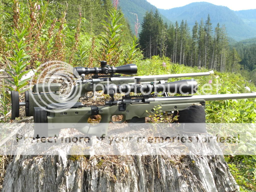

And my rifle of choice, Rem 700, .223
Trued action, RB trigger, 28" Shillen 1:7, throated for 90gr VLDs, AICS 2.0, Burris Z's holding a Sightron 10-50x60 on a 20moa EGW rail.
This is an older picture, and I haven't tried with the .308 yet.
