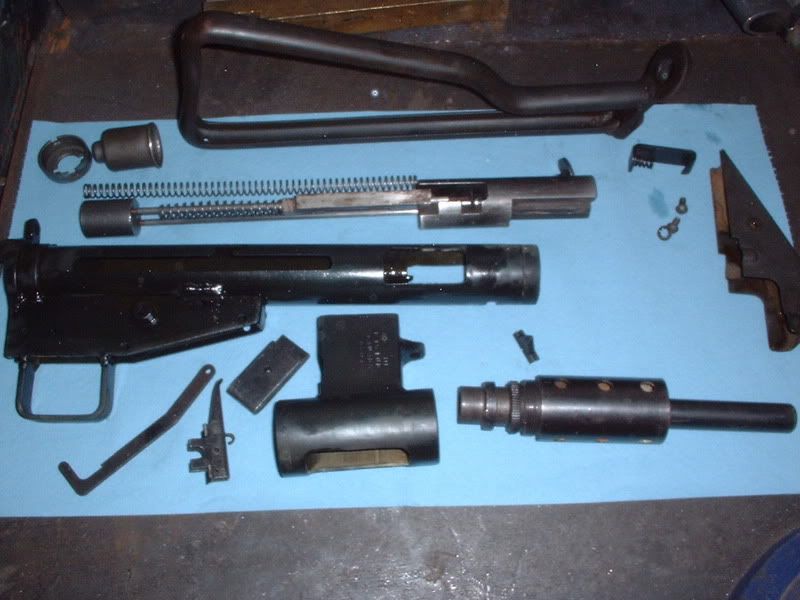

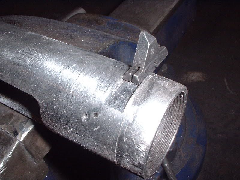

So this morning I hand filed the front sight dovetail, and sandblasted and blued the receiver and magwell.

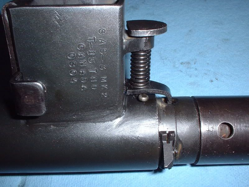

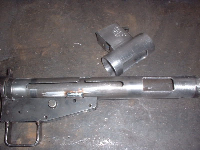

Because I moved the portion of the magwell back slightly, I had to modify the little plate for the barrel lock.

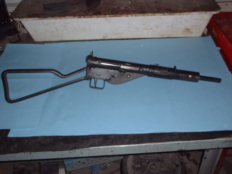

Gun is now assembled, and it cycles fine on WW2 origional dummy rounds. The true test will come on the range of course, but it certainly will fire one round at least.
On one of the US sights (1919A4.com) they were talking about the problems with the springs on these things collapsing from over compression. I'll likely use either a Bren or a 1919 spring to replace them if and when that happens. Todays commercial springs don't have the same quality as the mil-spec springs of days gone by.
These photos have been sent to the CFC tech. I'll let you guys know how it turns out. It's raining today here in Shilo, so the range test will have to wait for another day.

Well, heres an update for the guys who have been following this thread. I got my upgrade kit today, and got it installed in no time. Made a few other minor tweaks as well. Took it to the range, where I fired off 100 rounds. First 50 were hit or miss, but with a liberal oiling, and a bit of break in, the last 50 went as fast as I could load them (damn 5 round mags :mad: )
The upgrade comes standard on all the new SAS-3 kits. The biggest change is a full circle, much heavier hammer, which absorbs more of the energy. The springs are also a bit heavier, and a much tighter fit to the rods, so they can't overcompress.
With just a bit more tweaking, the gun gets to go for a trip to the big house. The RCMP labs have asked that it be submitted for testing, (shipping to them at my expense, return shipping (if it gets returned) at theirs.). So I will have my fingers crossed, and hopefully she comes home in a while.
