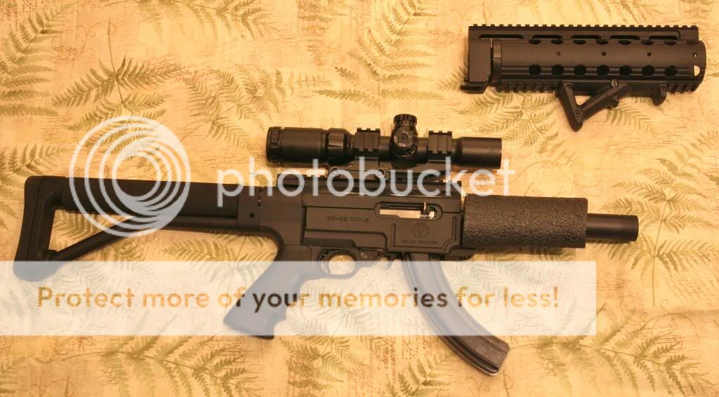

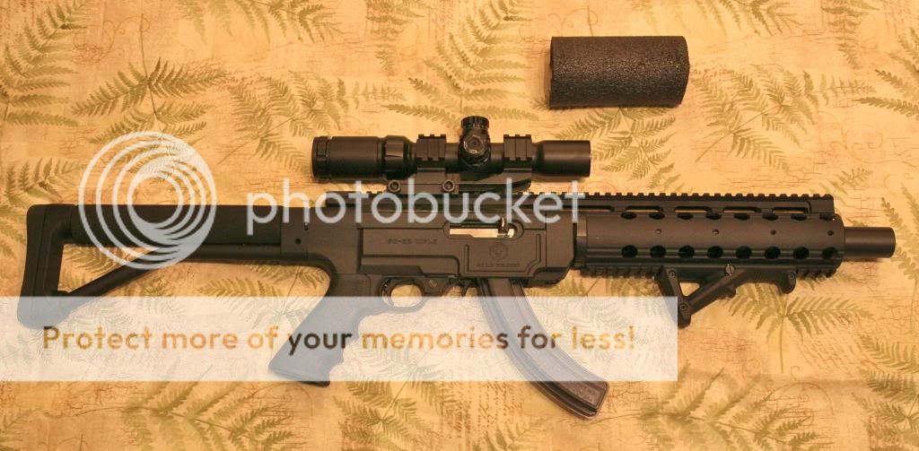

	So the question is: Can I buy a second front adapter (the part that attaches with two screws to the lower receiver cover, shown attached to the separate stock hand guard in this pic, and what hand guard would work? any suggestions?

Why not just use the same part and buy a second hand guard? I mean it unscrews... well... Er... with some effort....
Anyway you want the hand guard gcdavidson is using (below) which I posted in post 74... his was a 4" Ultimate Arms Gear hand guard seen HERE (but completely unavailable to Canada apart from walking it across the line) where mine is the same part from DPMS (Defense Procurement Manufacturing Services) called the Kitty Kat Free Float Tube seen HERE... if you get it before me that would be, well, awful...
I will probably not go that route after reading how hard it is to take the stock hand guard off without damaging it...
I guess I could buy the entire Nordic assembly and try to sell the upper and lower covers as spare parts, but that sounds like an expensive option.
...are there no other 4" ones that are readily available?
There may be, but not many round as such, there are quad rail 4 inch ones for sure, usually for airsoft...

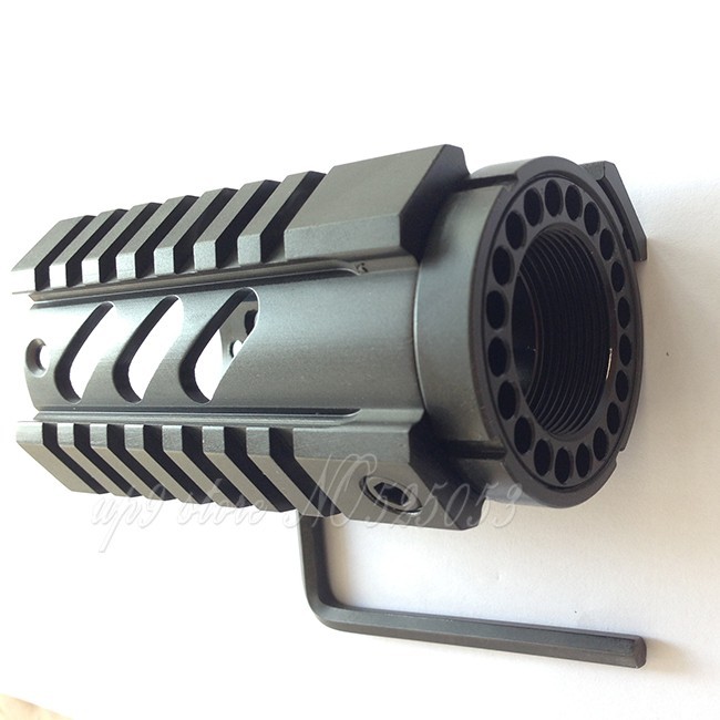

http://www.hical.ca/apps/webstore/products/show/3120524
I found this:
For $32 and free shipping on eBay (and they ship to Canada) but without the adapter, I have no use for it. I have sent an e-mail to Iron Eagle to ask if they happen to have an adapter kicking around that they could sell me. I must admit I prefer the smooth hand guard like you are getting and on dcdavidson's build.
