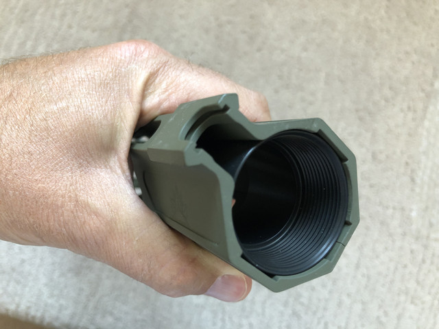

Thanks so much for this info. Regarding the Aeroshell grease... are there other options? All I can find is large $70 tubes on Amazon?
My barrel nut seems to not have much room for tightening. When spun into place, it freely spins what appears to be all the way to the bottom of the upper receiver threads. I don't think there is much (if any) room for tightening on the threads, it might be bottomed out before getting that far?
Are you experiencing that with barrel placed in the receiver, already?
I just placed the barrel onto the receiver, then handbombed the barrel nut in place and it seemed to almost bottom out. Zero threads showing and maybe 1-2mm gap between the barrel nut and the receiver itself. I was just wondering if when I torque to 35ft/lbs will there be any thread left to do so?
