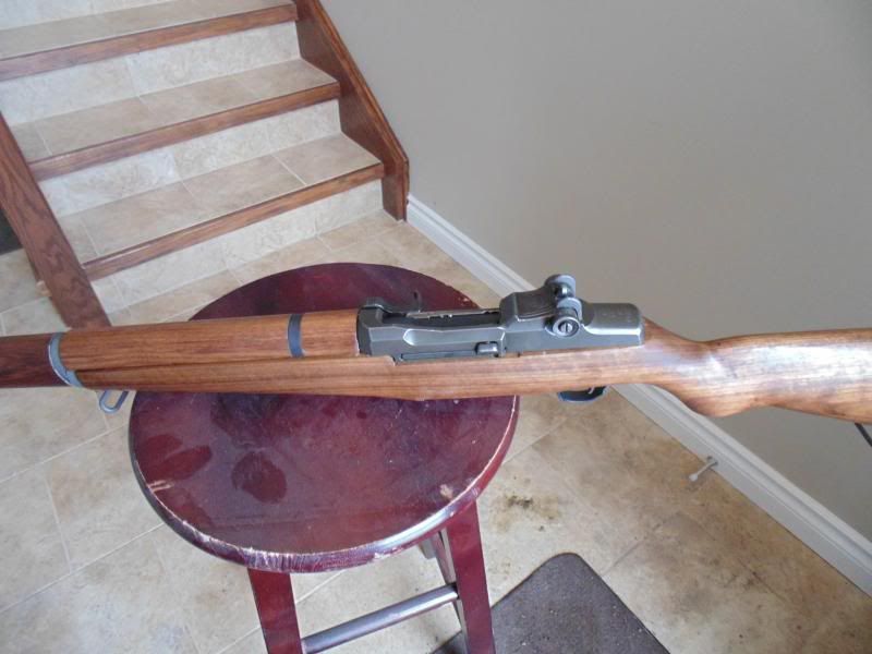

Got the last of my parts today and now shes all together, might try and match the colors of the wood now. Guess it's time to restore my sporterized 1903 now.
Great job on your build. Mine is nearing completion and have all the parts and just have to do the stock. Big problem is Pure Tung Oil or Raw Linseed Oil......What to do, What to do? It is Birch.
-Shawn
