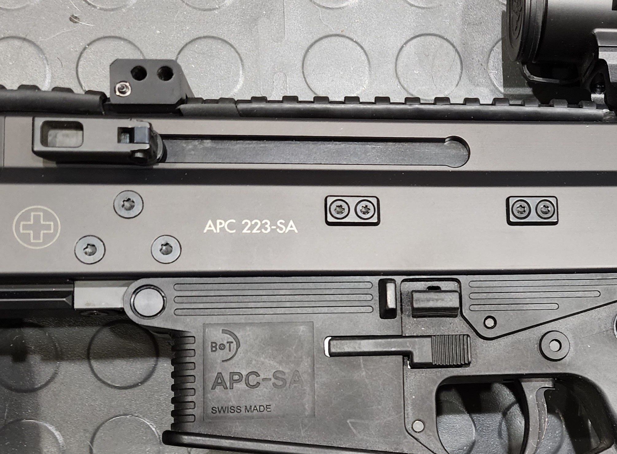

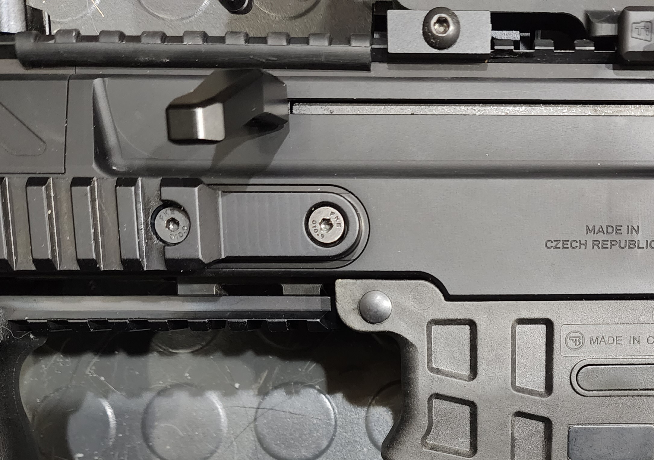

Beautiful rifles. But I'm Kind of used to the clean look of the AR, that all the screws on the upper have me nervous, should this be a concern other than it just ruining the esthetics ? Even the the charging handle on the fore end looks like its being held together with a Philips screw .
The screws in the Upper Receiver are used to affix steel components such as the Barrel Trunnion, to the extruded aluminum Upper Receiver shell. Any number of modern military-derived sporting rifles such as the B+T APC familiy or the CZ Bren 2 MS use the exact same system. Screws are also used to affix Polymer such as the Ejection Port Buffer to the aluminim Upper Receiver and in any other cases where non-weldable materials must be fastened together (eg. Steel to Aluminum). Provided that the screws are of a suitably fine thread-pitch, are high-quality with adequate torque specs and are Loc-Tited, the system is as sturdy as you will find and the screws will not loosen of their own accord..
B+T APC 223 (Note screws to Left for securing the steel Trunnion and screws to the Right for affixing the steel Bolt-Carrier Rail to the aluminum Upper Receiver):
CZ Bren 2 (Note screws to Left to secure both the steel Handguard Rail and Trunnion to the aluminum Upper Receiver shell):

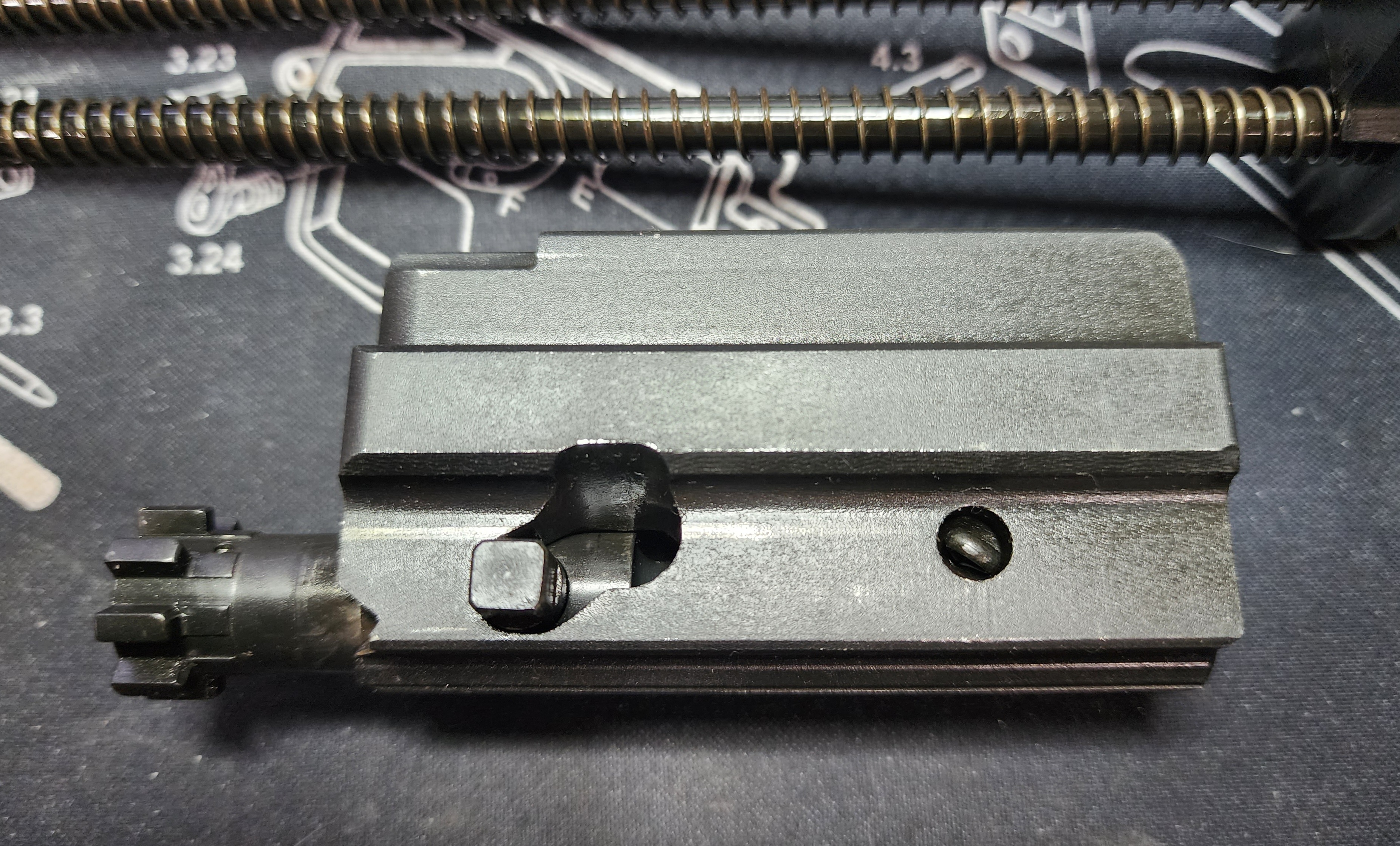

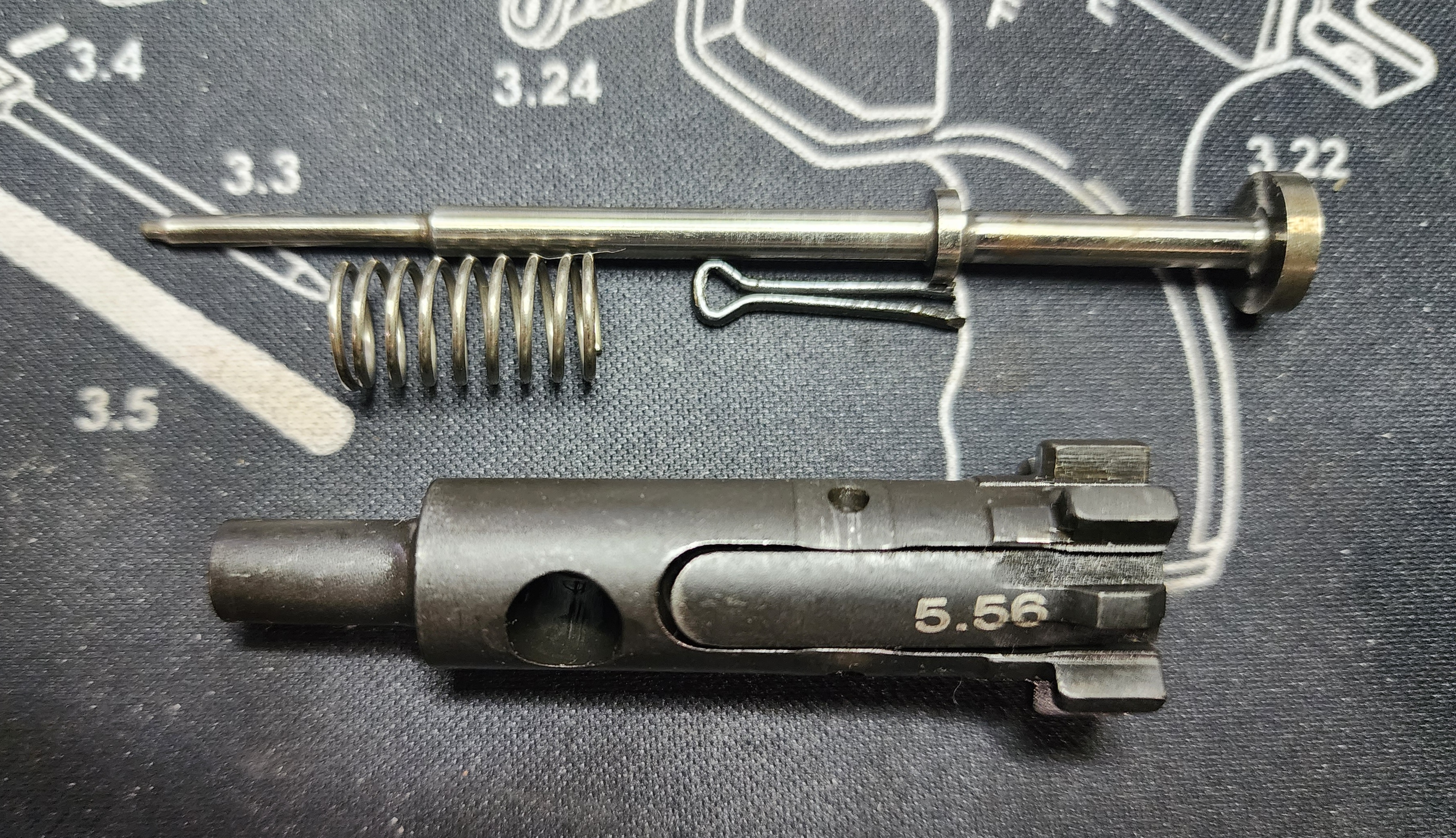

How does the channel the bolt travels in look as far as machining quality and how does the bolt machining/finish look?
The bolt shown in Sootch's rifle at 13:17-14:30 and onward has very visible tooling marks, how does yours look in comparison?
Seems like these rifles need a dedicated doctor just like the legend M14 Doctor!
The Bolt channel is cleanly machined, with the beefy, square Cam Pin channel precisely machined out of steel. The Bolt is as smoothly machined as any AR15 Bolt I have ever encountered. Of note is the fact that the Bolt and Carrier appear to be Parkerized, as opposed to Nitrited, which is a bit disappointing as park is far less durable. That said, parkerizing has been used on military firearms for well over a century to good effect, so I may be picking fly crap out of pepper with that particular observation.
Unlike the Cam Pin on some rotating Bolt firearms, the Templar uses a very sturdy and thick, square Cam to force the Bolt into and out of battery. All things considered, the Bolt, Carrier and related components are well fabricated and finished metal work.
