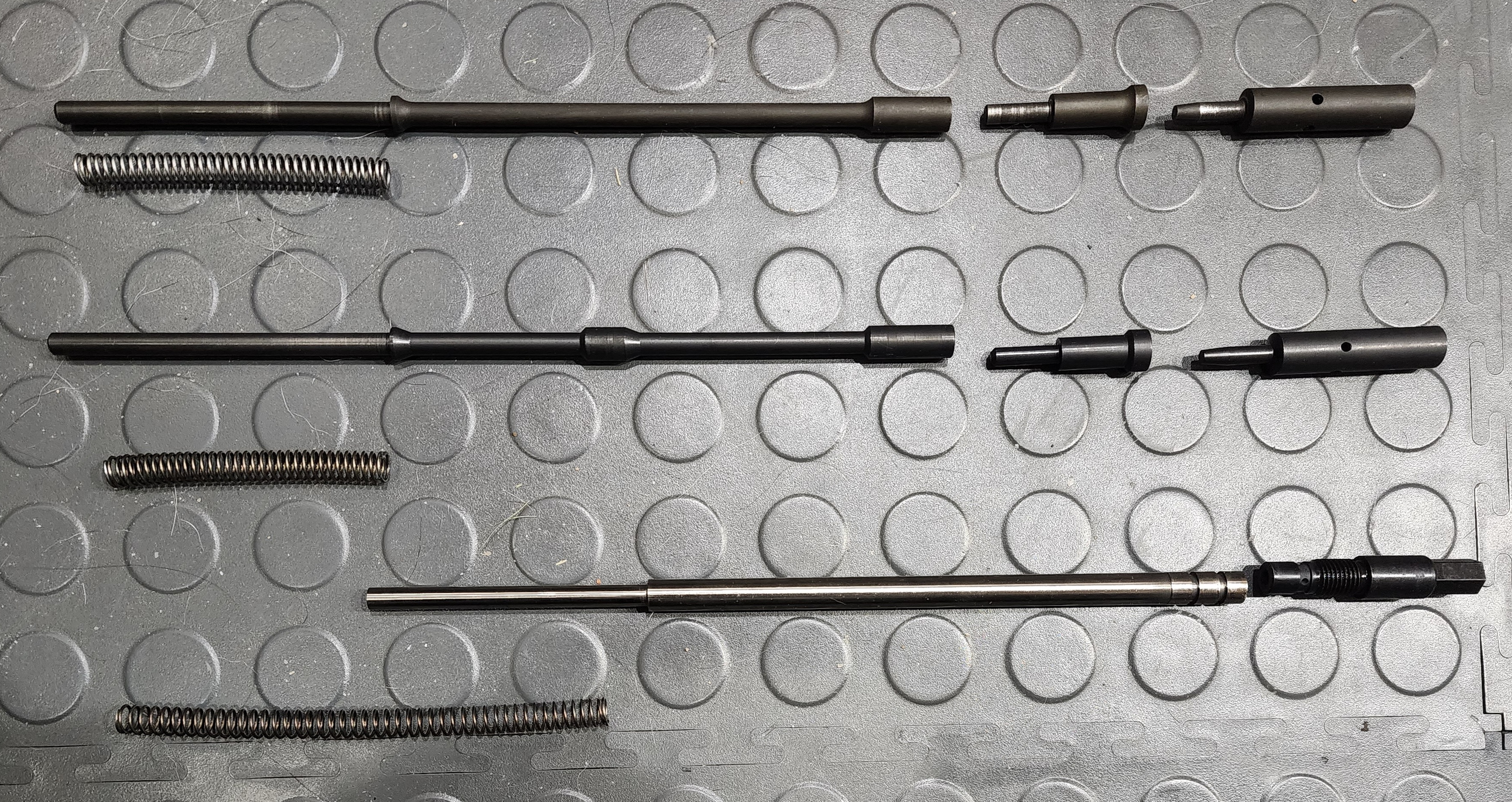

Let's see that thicc piston and gas block.
To be honest, I'm not quite sure how to go about that quite yet. It has to come out the front of the Gas Block, which means that the Hex-Nut on top of the Gas Plug must be there for tightening and loosening said Plug into and out of the Gas Block. But for the life of me, I cannot get that Gas Plug to budge even a mm with a ratchet-driver. Anyone have any bright ideas? In the absence of a manual I am currently at a loss. Next up will be to apply some heat to the area....

Finally got it. Thicc Boi....

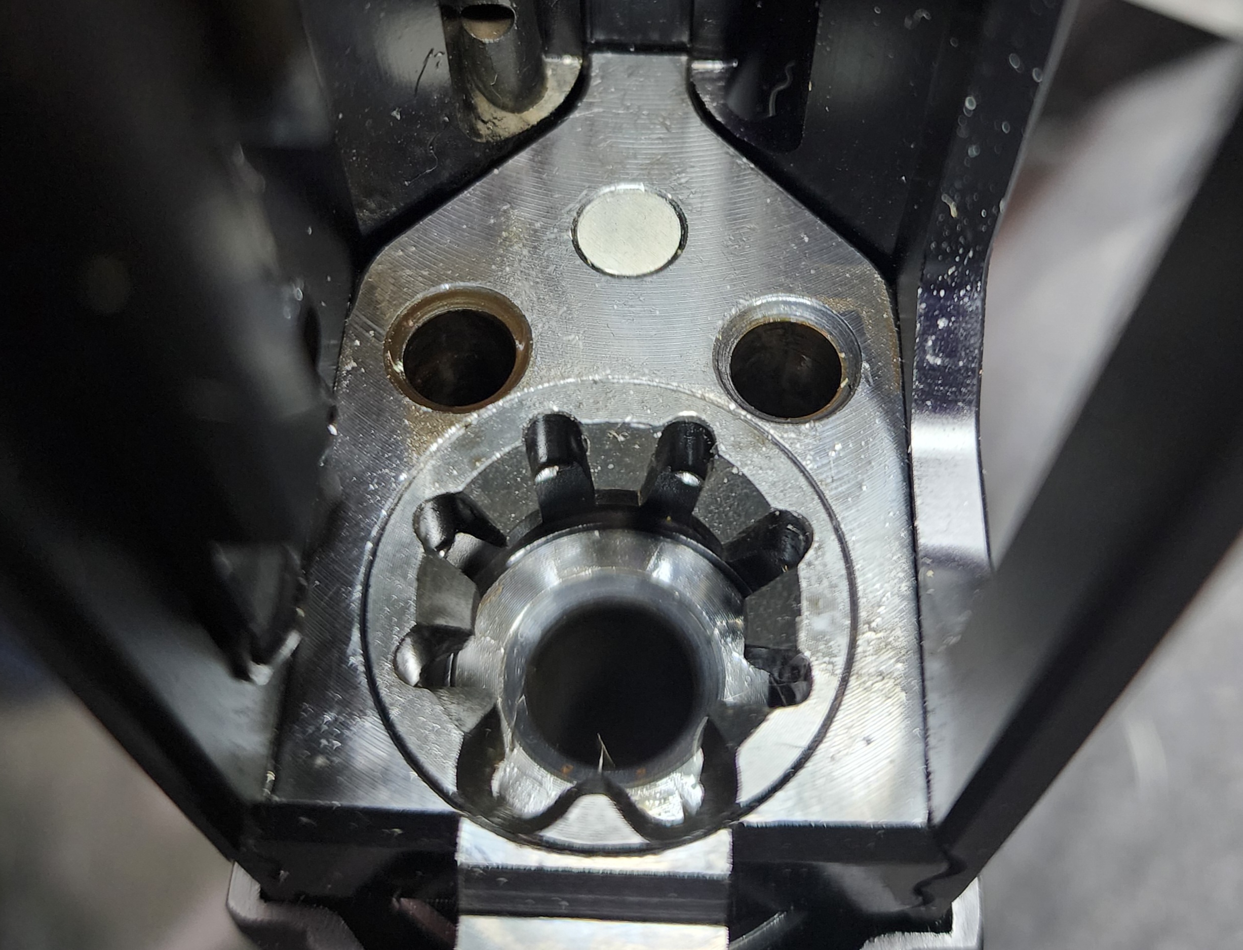

Hi Mark. Can you get a snap shot of the feed ramps? From the upper from underneath and maybe one from the ejection port with the upper and lower attached. Im curious about feed way engagement.

Here you go. Note that the Feed Ramps do not extend into the steel Trunnion as they do on a properly machined AR15 / C7. Aside from that, everything looks normal to me....

The Templar's Gas System does not disassemble like that of the B+T APC family, although the principle of removing a Gas Plus to free up a Spring-loaded Piston remains the same. To strip the Templar's system for maintenance you must first clear the firearm, then remove the Gas Plug using a 10mm socket. The thread pitch is standard "Lefty Loosey, Righty Tighty". Once you remove the Gas Plug the Piston will pop up in the Plug's place under spring tension. Simply tilt the firearm until the Gas Piston and Spring fall forwards out of the firearm. The Gas System is now stripped for cleaning/maintenance.

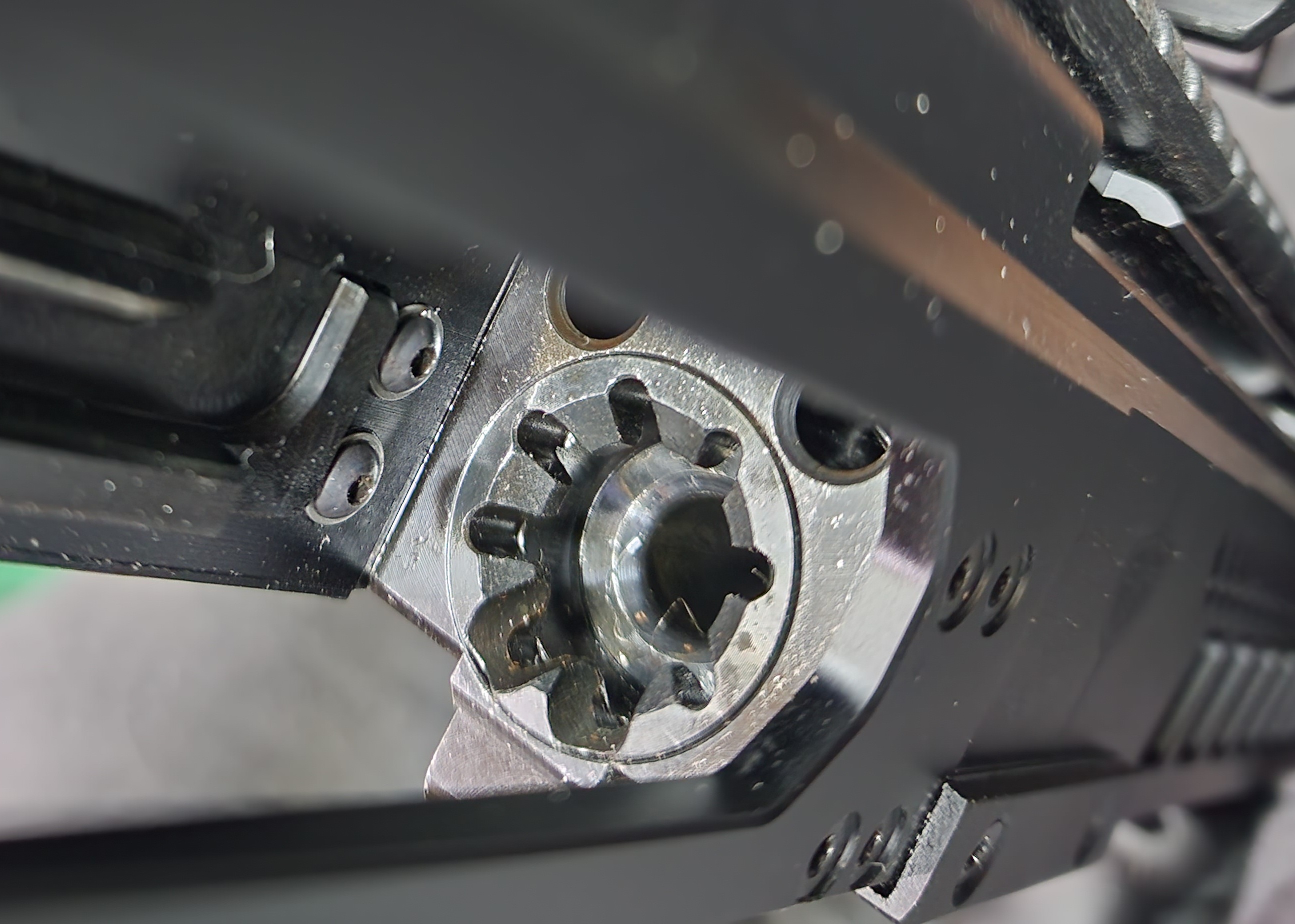

Anyone have any theories as to the purpose of that hole on the Right side of the Upper Receiver behind the Ejection Port and Above the screws securing the Rear Take-Down Assembly? It seems to serve no apparent purpose....

My understanding is it’s there only to be able to access the screw to fasten the Steel Cam plate insert.
