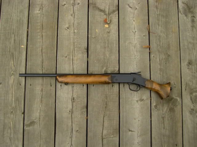

bottom one,

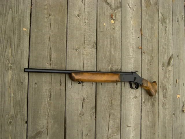

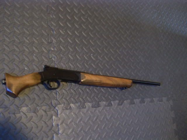

a rossi .410 with the barrel cut at 19'' and the stock cut.
i use it with slugs as a bush legal '' single action revolver ''.
quick draw from the hip holster, pull the hammer and shoot one handed.
not a '' survival '' shotgun but a fun toy to play with.
( yes, i know the stock is cut square, i prefer this configuration over a
pistol grip as the triangle at the top gives me something to wrap my thumb over for a better grip when shooting one handed )
