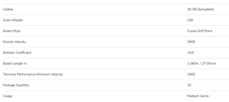

Most fusion bullets call for 1900fps minimum. The 30-30 fusion is PROBABLY different, but I would want to confirm that personally. I highly doubt the bullet wouldn't perform at 200yds, but better safe than sorry.
Wow, I wouldn't have imagined they needed that much speed. They are pretty soft in my experience.
Happy to take your word tho.
I actually forgot the fusion was designed for max weight retention, which would explain that.
right, I looked at the 30-30 page. Didnt see the terminal speed either.
1900 is higher than the rated speed for the mono coppers I shoot nowadays.
I'd be surprised if that was actually the right number.
