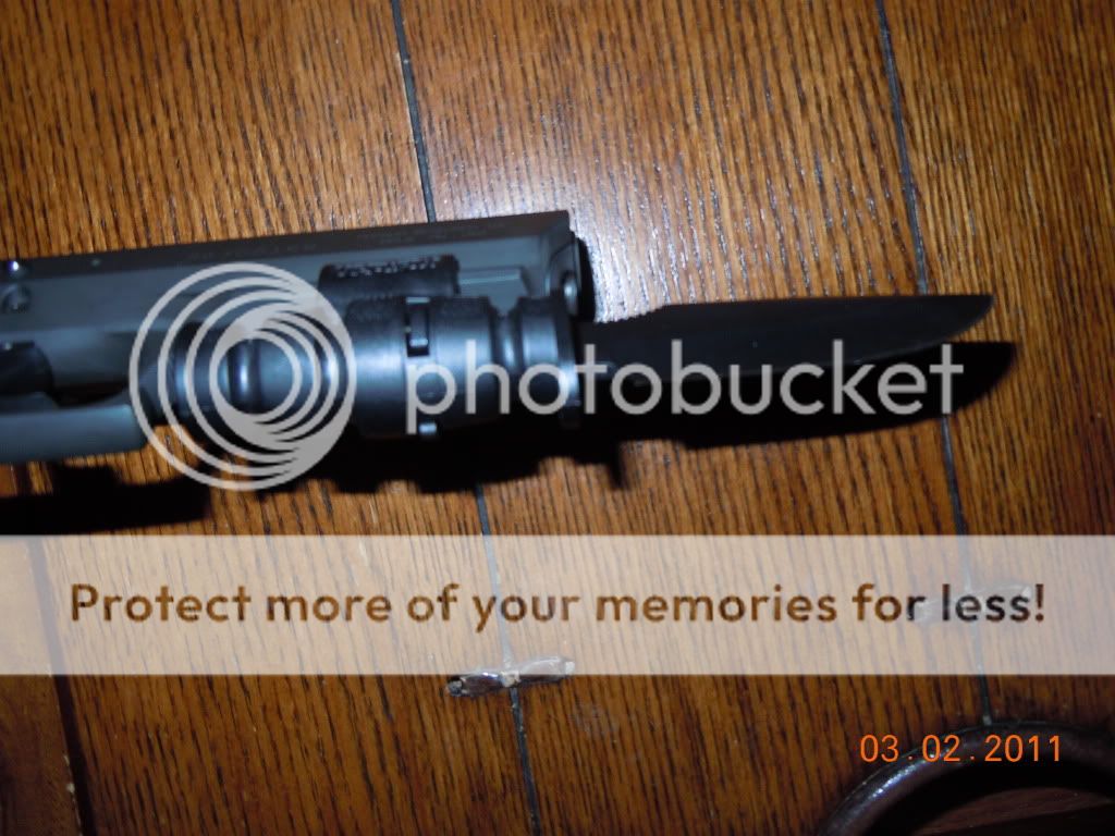

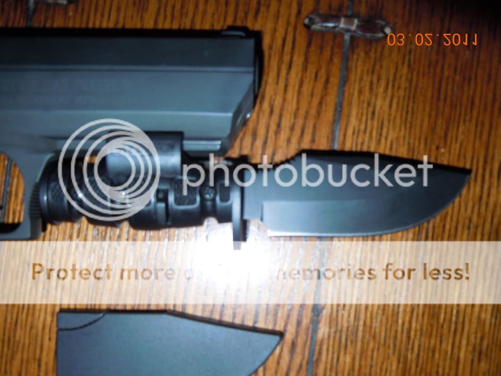

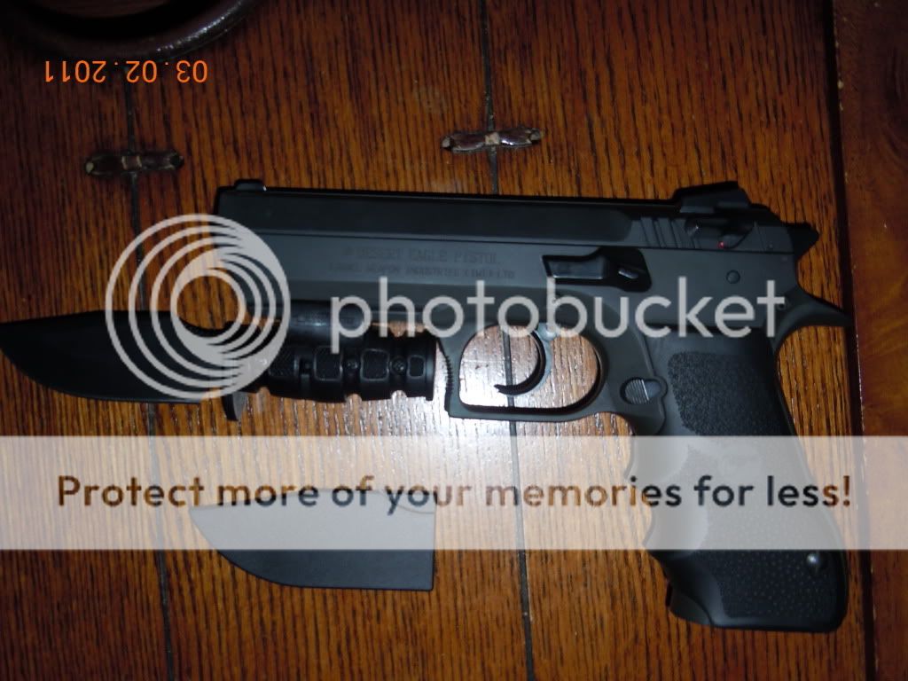

The reason I want a tactical is because last year I bought a bayanet for a hand gun(impulse buy).Now I won"t put it on my 45, but for a fun gun like the tactical why not.I already have all the clips I need and if I get a gsg from a fellow nutter for a good price I figure it would be a great change up gun at the range.

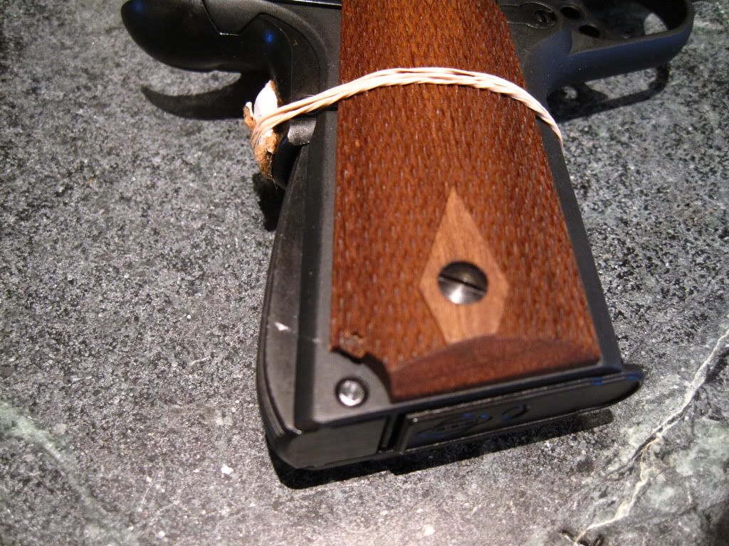

So I thought ,lets take the magazine disconnect out. Not a big deal ,I guessed .
Problem was I did not have a Punch ,so I invented a upside down drill bit in my powerdrill . Got it out and took the magwell out ,:eek: let go of the grip safety and the parts underneath came loose .Take the magazine disconnect out of the magwell ,pull the spring and "zing" the dam thing fly's through the dark man cave f:P: .
On my knees ,flashlight on I'm zooming every inch of the floor and find it !

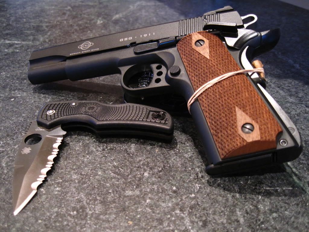

I put the magwell back in ,push the pin in and ..... slip with my improvised tool ,scratch on magwell ,frame and chipped walnut grip. :HR:

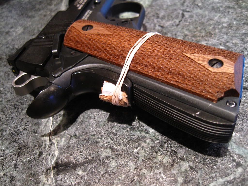

On the range everything works well, only the gripsafety does not work for me . I have a really high grip on my guns and so I don't disengage the safety well enough. Thats were the rubberband and piece of cardboard comes in the game.
Anybody can tell me how to take the gripsafety off ?

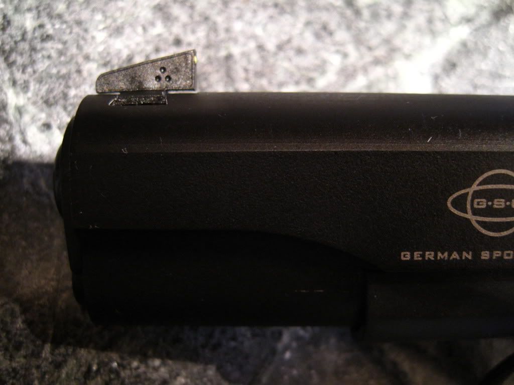

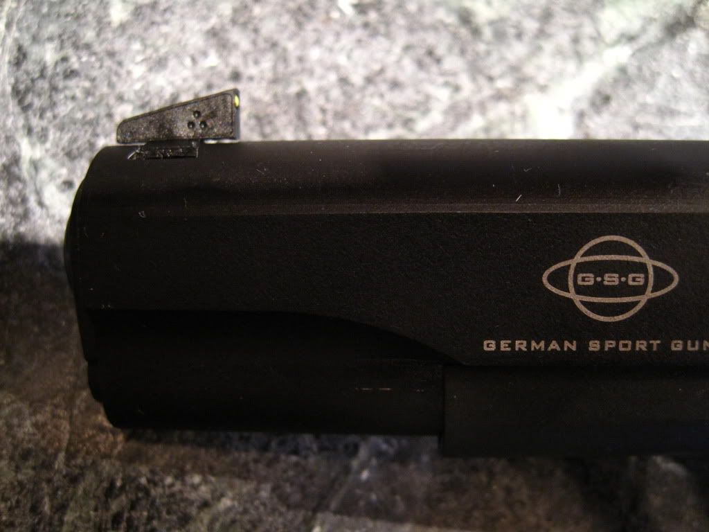

and I had to put the tall front sight in , but it is kind a loose in the notch ,so I have to screw it in harder and front sight comes a bit higher this way ? Is this normal ?
Now Pics.
The first rule of working on a 1911, and especially one with nice checkered wood grips on it, is to remove the grips & put them aside in a safe place. Ask me how I know this.... :redface:
As for the improvised punch you might have been better of just using the drill bit reversed without the powerdrill to push out the mainspring housing retaining pin. With the hammer uncocked it does not take much pressure to push that pin out... ;)

The thing with the front sights is that the screw goes through the front sight and does not engage into any threaded "hole". It just, as you twist the screws, hits bottom and tries to raise the whole unit until it is wedged firmly against the sloping angles of the channel. Screw tight enough that it won't budge. And since the screw does not engage into any alighnment hole, guess what? You have to align the front sight by eyeballing it. Equal spaces on both sides.
But mind you, having the front sight slidable (not by design) means that you can adjust for extreme windage by playing with both front- and rear-sights.
