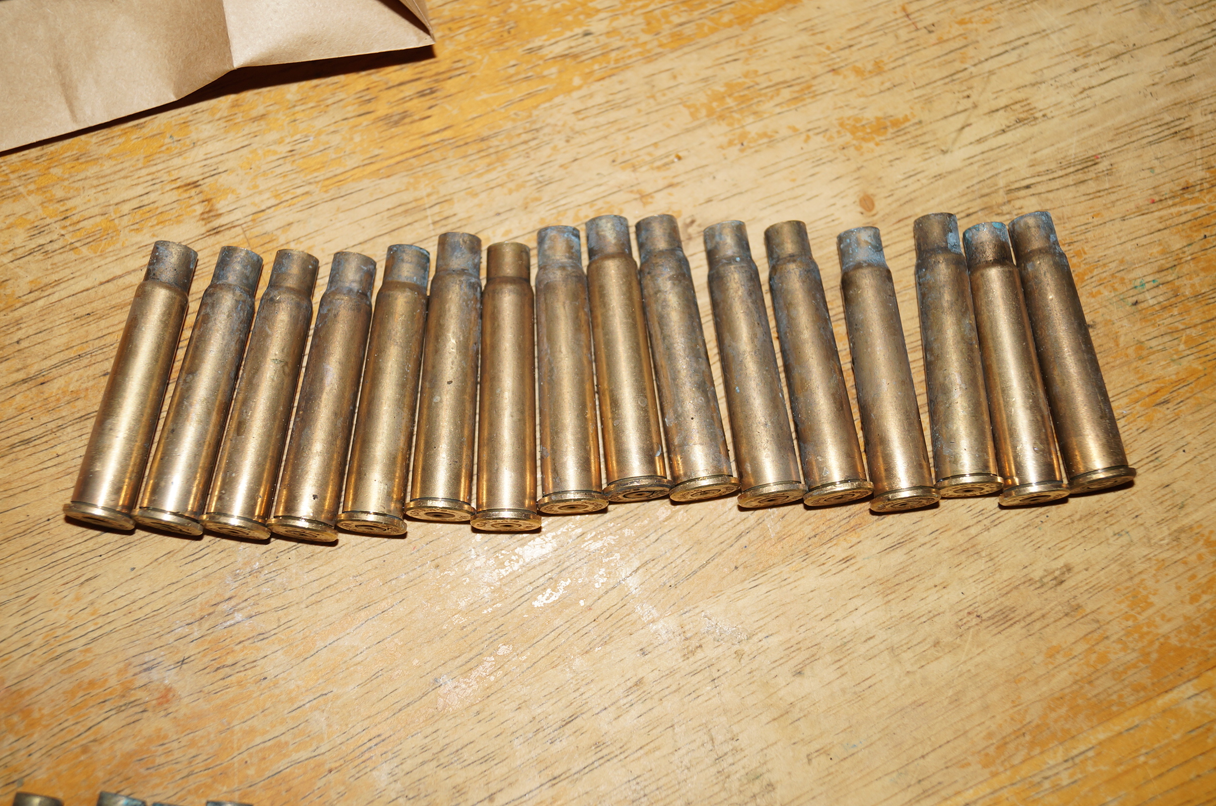

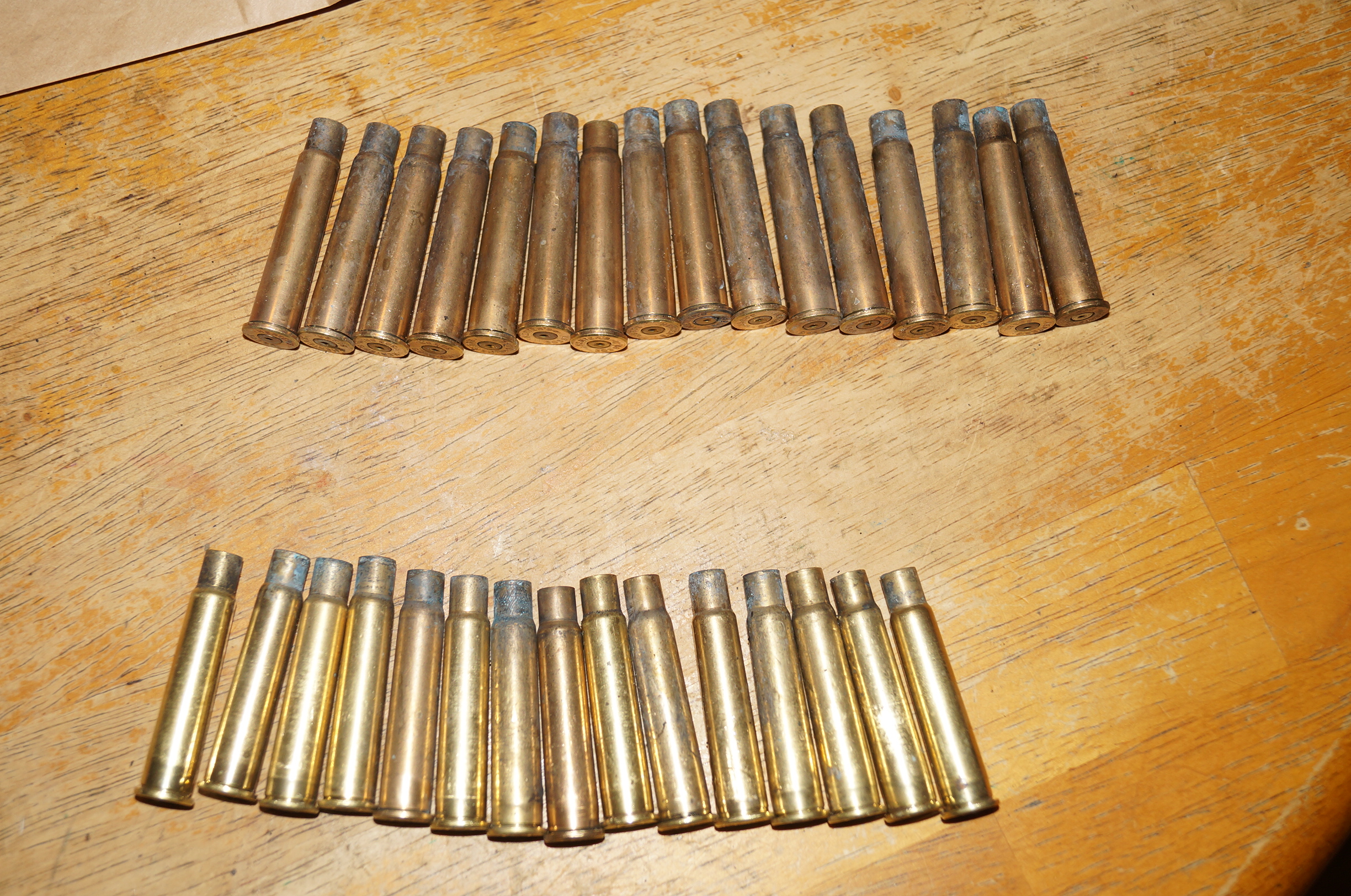

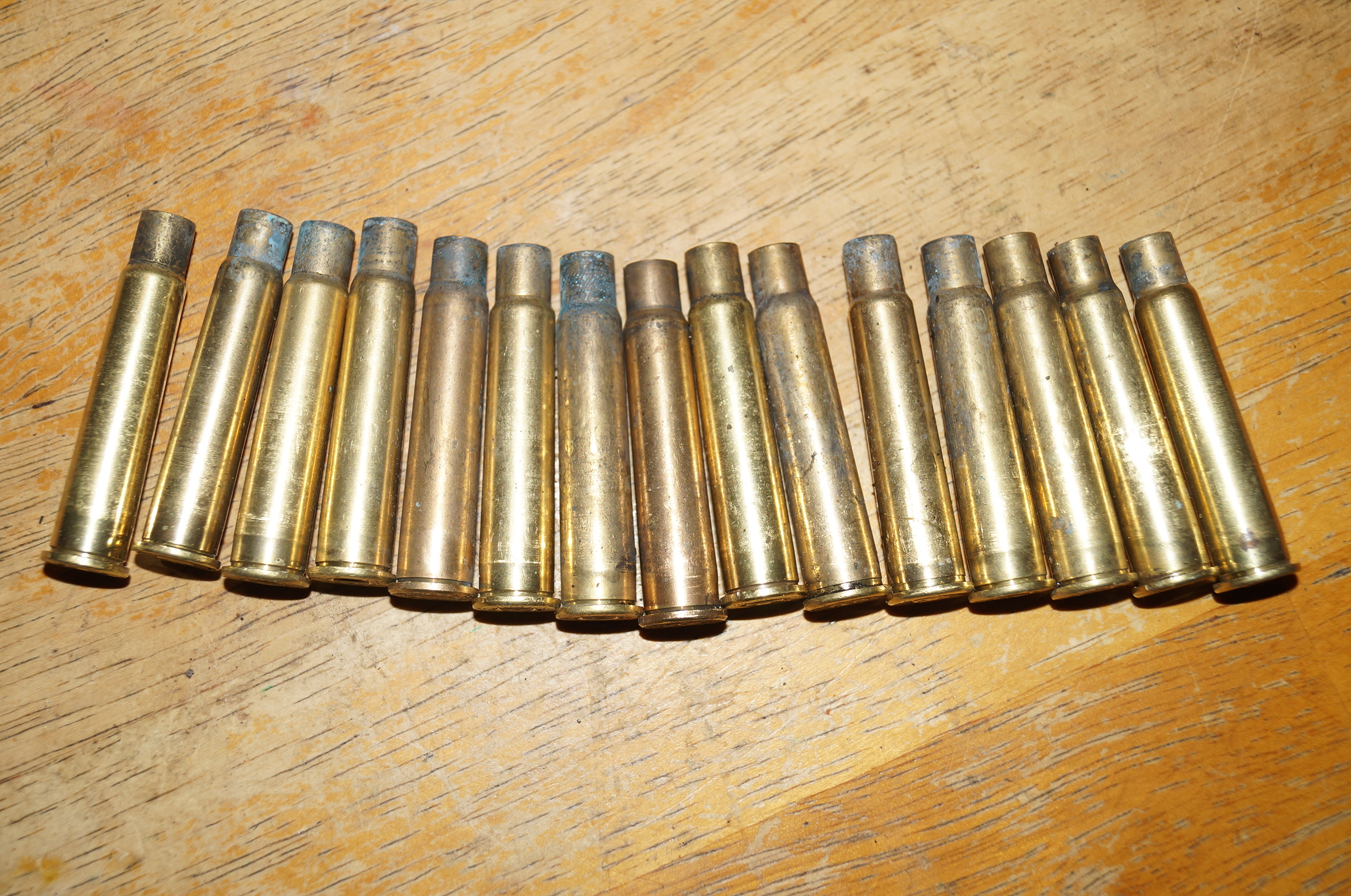

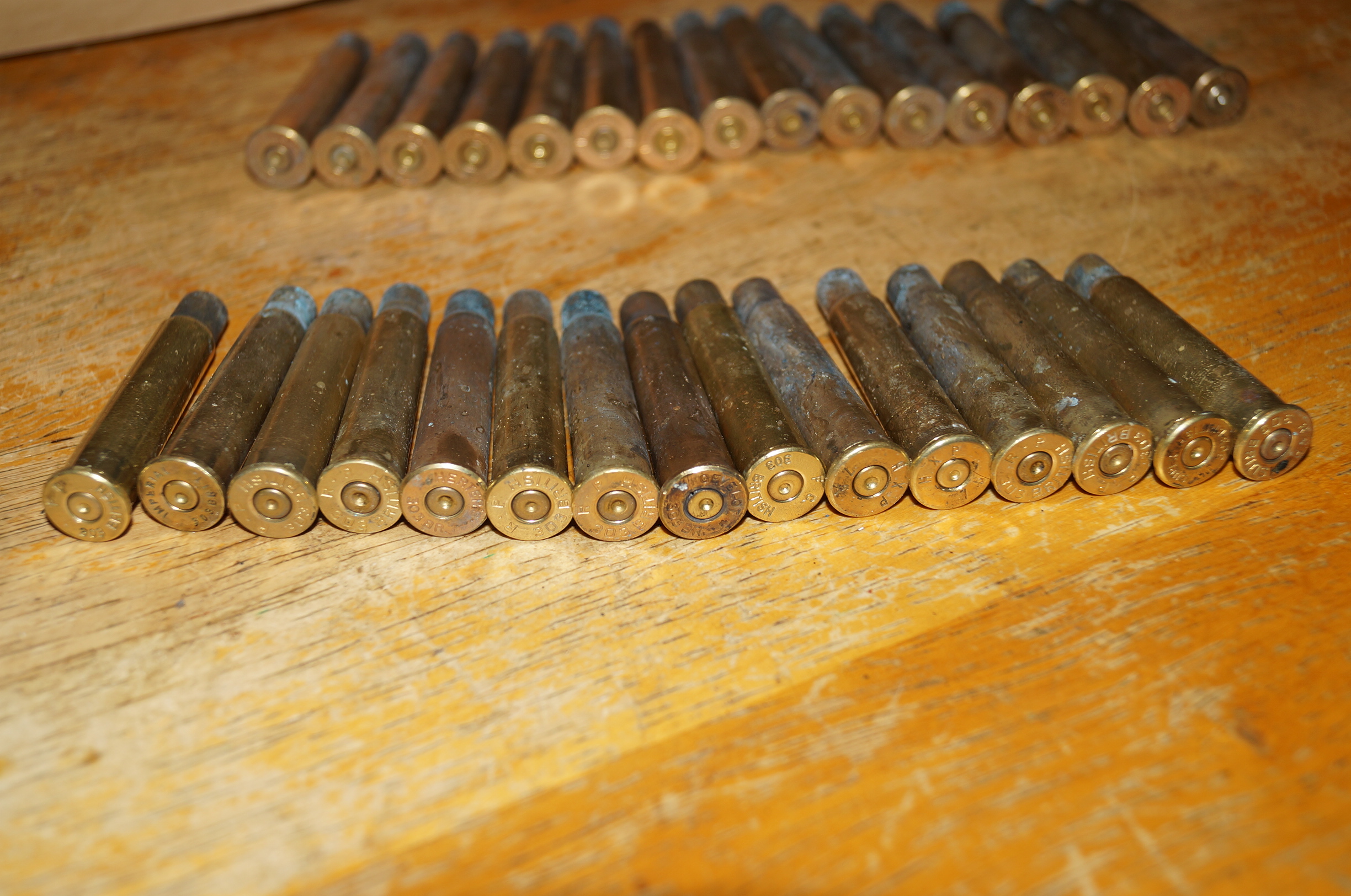

More testing results are now in - and they are definitive.
After three known firings all of my North American commercial brass shows those nasty shinny rings. After the same three known firings none of the Herters brass show any signs of the shinny ring problem ... not one ... ZERO.
This has nothing to do with with headspacing because I get his result regardless of which of the four guns I used for the shooting. The myth that those shinny rings are a sign of headspacing problems is plainly old school nonsense. Those shinny rings are sign that the brass you are using is junk.
Since nobody was able to definitively tell me whether they had direct experience as to whether Herters 303 British brass is better than the other stuff, I did a bit of an unscientific test today.
A while back I had bought two bags of 303 British “once fired” brass. One bag was mixed and included cases marked R-P, Imperial, FC, Gevelot, HXP and WW Super. Most were R-P. The second bag was all Herters brass. None of the cases had that shinny ring near the head and all were cleaned and resized as received. The mixed brass was reloaded to about 5% under max using a really old bunch of Speer 150 grain bullets – which I think were .308s. The powder I used was recovered 54R power for some of the mixed brass loads and 44.5 grains of H414 for others. The Herters brass was loaded with 44.5 grains of H414, pushing 150 grain Hornaday 308 projectiles.
These reloaded rounds were shot through a cross section of guns – a No.1 MkIII*, a 1949 (F) No. 4 Mk 1/2, an Ellwood Epps custom one-piece stocked no. 4 Mk 1 and a Deluxe 555 Globco Mohawk in 303 British.
Since I was not necessarily trying to be scientific - but rather was just out to have some fun – I was pretty random on which guns shot which cartridges, but suffice it to say that all four guns shot cartridges from both the mixed lot reloads and the Herters brass reloads. As far as I'm concerned, the results are definitive, but the pictures are included here so you can zoom in and make up your own mind.
After firing 15-16 mixed brass cases about 6-7 cases definitely exhibited that nasty shinny ring. Out of the 15-16 Herters brass cases, zero cases showed those shinny rings. Yes, the Herters cases are probably a bit dirtier, because they all were loaded with H414 but no biggy there. All the cases that were shot from the 555 Globco Mohawk ejected properly and were thrown about the same distance from the gun; so I’d say all loads were about equally hot. No, I didn’t chrono everything – like I said I was really just out to have fun.
My conclusion is that the Herters brass is not prone to develop those nasty shinny rings the after first couple times that the cases are reloaded (noting that this was already “once fired brass”). If I had the time, I’d section a case from each of the two lots – to see if – as I suspect – the Herters brass a has a real web that the commercial brass lacks. I’m not a retired guy, so I doubt I’ll get around to that for a while.
You be the judge. Links to pictures are provided. (click on the blue links).
All Brass together, Herters Brass 1, Herters Brass 2, Mixed Brass 1, Mixed Brass 2
BTW I used recovered primers and so some show a bit of leakage. No biggy there either
