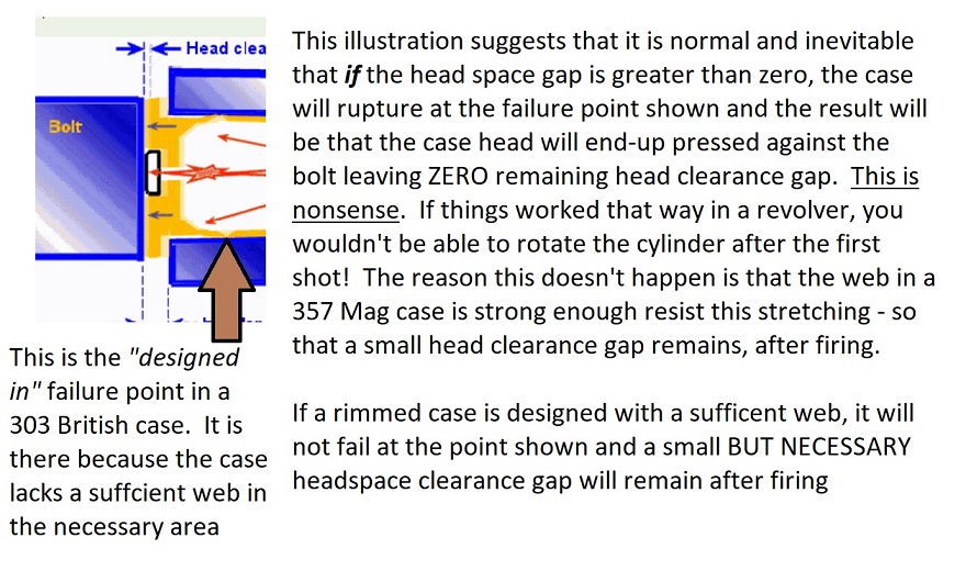

This is a really well done review of the issues and is quite consistent with another well done resource found at (Click on this LINK).
However both come up short IMO in that each relies on the mistaken belief that it is Okay/ normal for a cartridge to stretch almost to the breaking point at the area marked below, if their is any amount of a gap between the base of the case and the face of the bolt - that is if the headspace gap exceeds zero. That is crazy! If the headspace gap is zero, you couldn't raise, or close the bolt. Consider the case of that other really common round we all know called 357 magnum. If the back end of the rim was pressed so firmly against the the corresponding surface of the frame - with zero clearance - the cylinder wouldn't be able to rotate! And if a revolver case failed at the stress point shown and ended-up TIGHT against the area where the back of the rim meets the frame, you wouldn't be able to rotate the cylinder after the first shot! The reason this doesn't happen in a 357 magnum revolver (or 30-30, 225 Winchester, 7.62x54R in other action types) is because these don't fail in a way that reduces the headspace gap to zero.
See this illustration:
All guns need a small headspacing gap - both before and after firing - to function properly.

It seems impossible to overcome the mistaken belief that "excessive headspace" is to blame for short brass life.

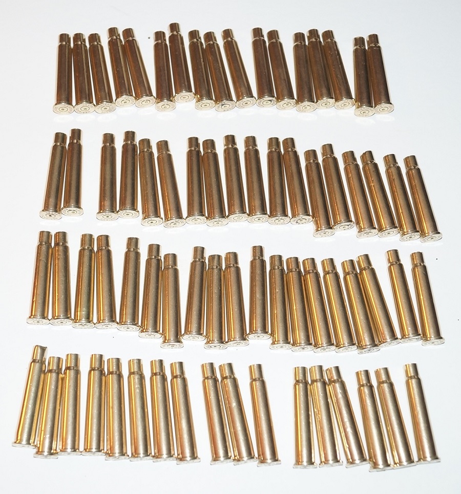

Here, once again, are the links to photos after a total of just two firings. (click on the blue links).
All Brass together, Herters Brass 1, Herters Brass 2, Mixed Brass 1, Mixed Brass 2
I believe that what's really happening is that, on firing, the Herters brass TEMPORARILY stretches lengthwise (axially) - to briefly close the tiny necessary headspacing gap and then it springs back again - as it is supposed to. This almost instantaneous spring back restores most of that tiny but necessary gap - without opening-up an internal wound at the expansion ring area. It does this because it has enough internal web to spread the temporary stretching forces over a greater area.
The mixed commercial brass is all "fruit of the same tree" - having been produced cheaply without enough brass in the area where the web should be. When it is stretched, the case gives-up internally at one point and doesn't fully rebound to restore the small, but necessary headspace gap. The next firing further stresses this already-damaged area. You know the rest of the story.

I've done half a dozen FL reloadings of my Herters brass and the loaded rounds in my shooting box look like brand new factory ammo - with no signs of any expansion rings or any of that nonsense. I like that.

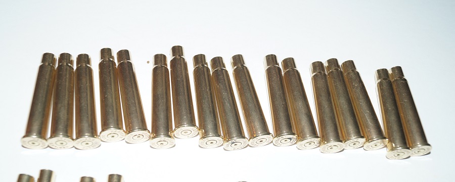

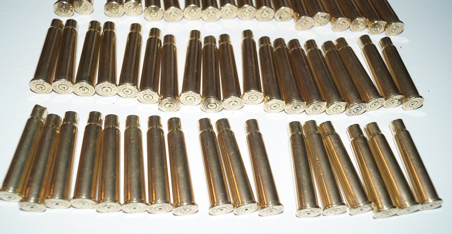

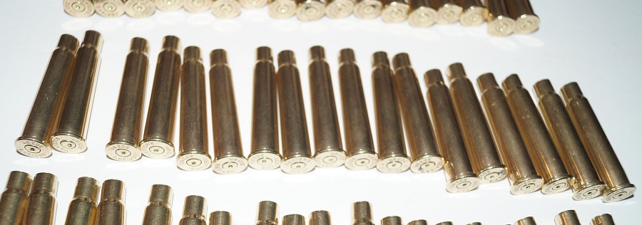

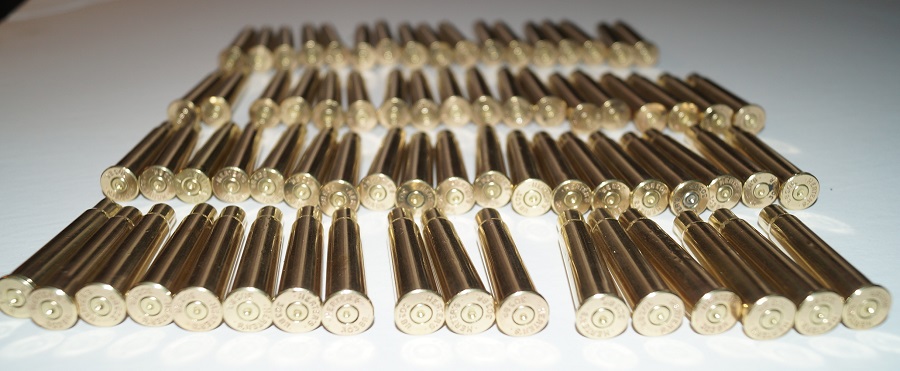

Here are some pictures of my Herters brass. I bought this off an auction site as “once fired” – but the history from before I got the stuff is unknown. The brass would be at least 30 years old and could have been fired many times before I got it. Since obtaining this stuff, I have fired it at least six times – using a cross section of at least 5 guns – Three L-E pattern guns and two (or maybe three) 555 Mohawk semi autos. The loads were all jacketed, full power loads – some using steel core projectiles scavenged from 7.62x54R surplus ammo.
After at least six firings I have had ZERO case failures, split necks etc. The pictures show that none exhibits even the first signs of expansion rings. These aren’t babied guns that have been subjected to multiple bolt head changes to get the headspacing just right etc. Just a half dozen honest, run-of-the-mill used Lee-Enfields, Mohawks etc. No fruity treatments with o-rings here – or diddling around with that pus*y stuff of trying to match the brass to “just this gun” – and getting the cases to headspace on the shoulder. We are talking about full length sizing each time – just like the big boys do.
The few dimples on the sides of the case are typically where the brass was thrown violently from the autoloaders – and the case impacted on some hard surface. These are as fired but have been cleaned by tumbling.
The point is stop blaming your gun and its “headspacing”, if you get expansion rings and head separations. Your problem is you are using junk North American commercial brass – where the maker cheaped-out and left-out the NECESSSARY internal web – when case was made.
