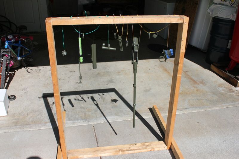

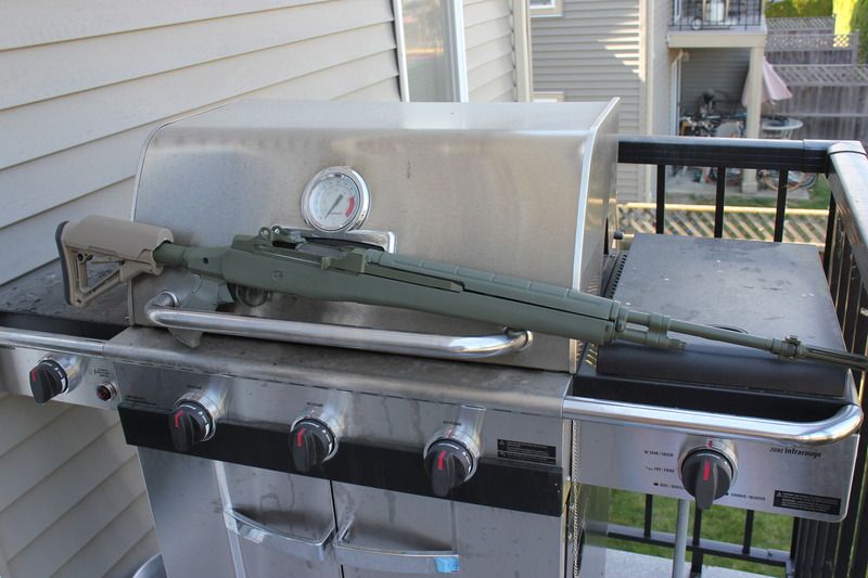

I finally got a day to paint mine. I made up a wooden rack with some 2x4's that I had laying around. I sprayed it on Sunday and left it till today to cure. I painted the stock with Tremclad OD green and the metal with Cerakote OD green. As you can see that both of there versions of OD are much different from one another. No matter as it's not staying that way anyways. I didn't want to use Cerakote on the stock in case it doesn't stick to it good enough. We'll see how well it lasts, if all go's well I camo the entire rifle with Cerakote.

nicely put together, very clean. a range report on how the new configuration handles would be interesting. where did you source the cerakote? tough to get a dealer to sell it in Canada.
I ordered the Cerakote direct from them. I live very close to the border so shipping was minimal as I had it shipped to my US address and picked it up from there.
