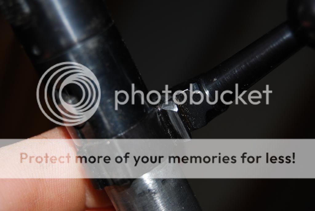

Take a look at your bolt. There might be some fines in there that's creating rough travel. That's what's happening to me.
The 2 piece firing pin has a little extention that travels along the incline and locks into place. Well the metal there is soft and on mine after a few cycles has worn down quite a bit. I'm sure this isn't that much of a problem but after few thousand rounds that part might need to be replaced. I kinda wished they used a harder material there.
I also fully disassembled my gun and smoothed everything out. Put radia on every edge that's not part of the sear engagement. There were burs everywhere. Now she's smooth and cycles almost effortlessly. It's a great design but quite rough around the edges. Next step is to apply HBN to all contact surfaces.
