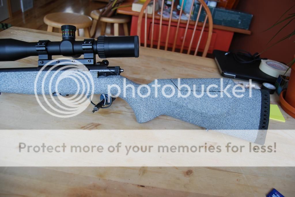

so i have been talking to my brother about adjustable cheek pieces and so had to build one to help get a proper sight alignment. problem with high power optics on a .22
[/URL][/IMG]
[/URL][/IMG]
[/URL][/IMG]

Good job on the cheek piece Foreign, it will surely look great once you are done refinish the stock. Did you think of any ''cleaner'' thumbwheel?

i would love a cleaner thumb wheel. but thats the only thing i could find at canadian tire. whole build cost about $2. used the left over lamp "pillars" for the hole. an old hex drive bit for one of the shafts and a ladder hook for the other one. thinking of using some epoxy and casting a thumb wheel around the current bolt. just trying to decide on length at the moment. i didnt want something that you needed an allen key to operate. like everything to be able to be done by hand. i tend to forget tools at home. :)
If that is a 1/4 -20 bolt you can get nice threaded plastic handles in a couple of shapes and sizes at Home Depot in the hardware section. They have these and some three pointed ones that I know of.

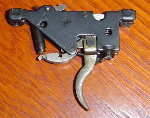

Silly question: Do you know what's the spacing between the trigger mounting screws?
I'm thinking, since they 'copied' much of this rifle from the Anschutz... I wonder if one of these would fit... 'older' Anschutz 1408 D-U1 trigger (1-3lbs)
Trigger.jpg~original
