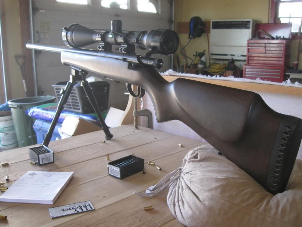

did not do any trigger work, bedding, free floating at all yet. shooing at a bench, front of stock on sandbag
was dialing the new scope at 50 meters:

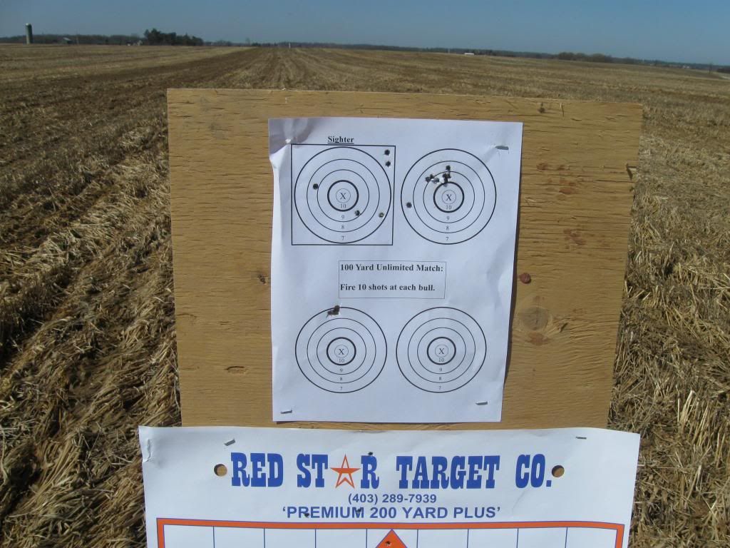

Then back to 90m or so:
clearly could do better at 90m, if I didnt pull some shots
still clearly could do better at 90m, if I didnt pull some shots
I don't know.. 'laterally' those 90M pics look pretty awesome to me!
The vertical separation could be just ammo charge variation... I was shooting some cheaper Winchester stuff at 60ish-yds and KNEW I was going to hit low before it even hit the paper on some rounds that felt like they were undercharged, I could feel it! and then some I knew I pulled, but if I pulled it ALWAYS went right....

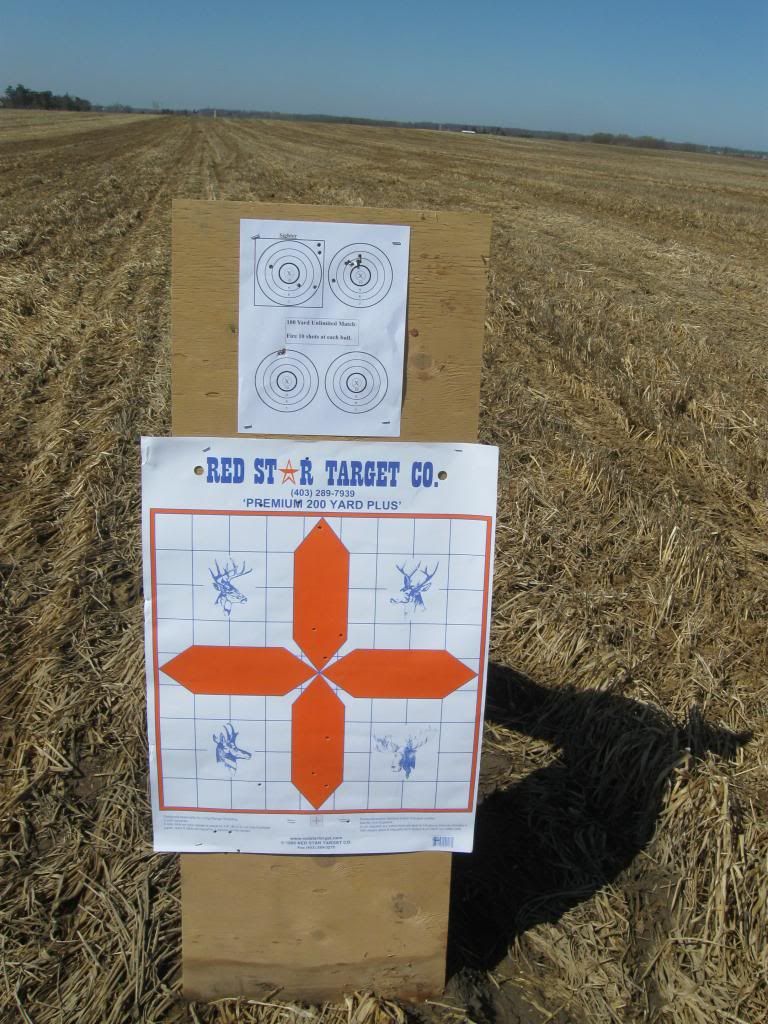

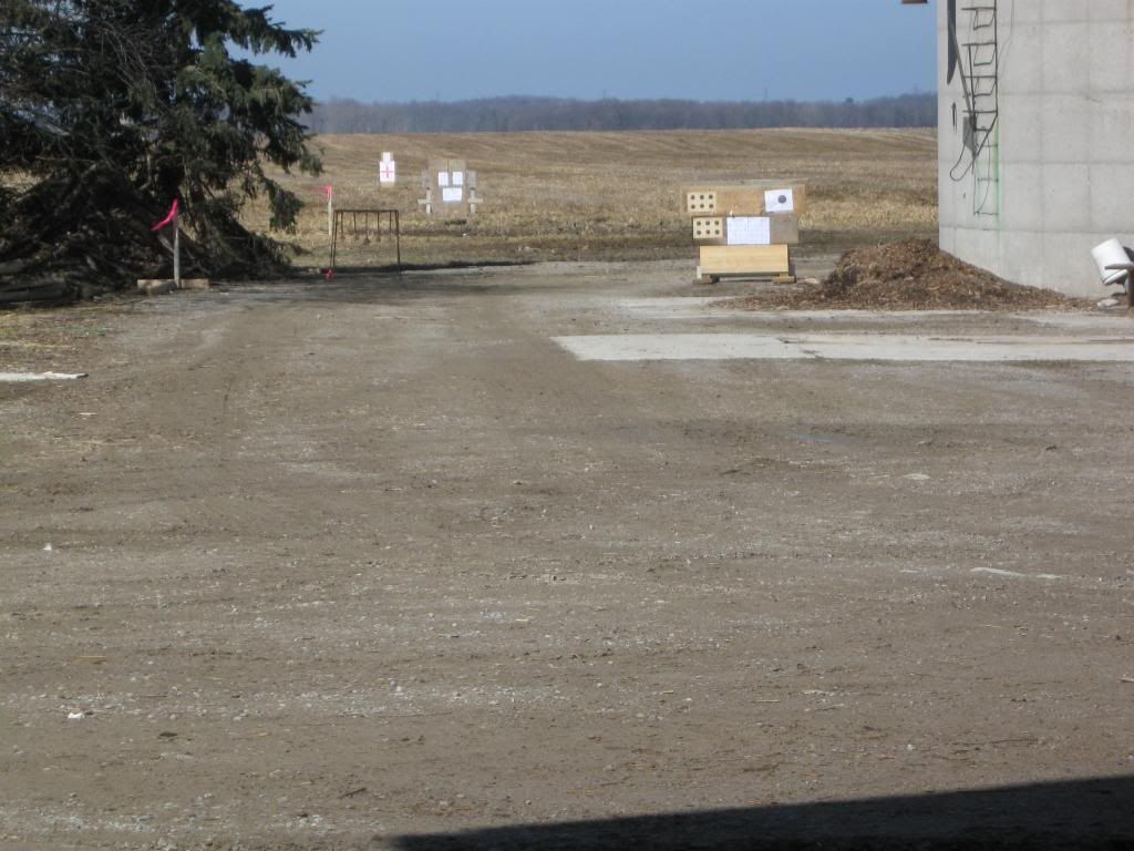

Finally had a day with light winds, so out to 150 yds we went. All over the place at first, until I started to use the mildots for height, and held off to the right for wind. Lost 2 bullets to the sighter target, and then the wind quit changing, and I started to adjust for it, and presto. Probably unrepeatable, but whatever lol.
