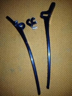

at the dollar store I found a WHOLE row of ladies hair clips! and I think people were looking at me a little weird because I was a little too excited about them! ...20 trigger springs for a dollar!
heres the 1 I ripped apart that has its held up a few months now with a very nice light pull that hasn't seemed to change..

Sk8, picture is too small, can't really see those springs. Even after your and minis comment and looking at a few post on rimfirecentral, I'm still kinda worried about using a non-firearm spring, but I guess I might just be over cautious.
Don't worry about it, a spring is a spring is a spring. Find one that works and enjoy. I have piano wire, bobby pin and safety pin return springs in my 10/22's and a bic flint spring in my Savage accutrigger and they all work fine.
